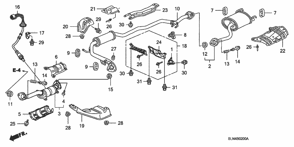

Originally Posted by gfrobe
Dealer wants $250 to replace it. $150 for part and another 100 for labor, which seems high. Anyone know where I can find the part number? I'm googling and keeping coming up with the 2008 shield but my car is a 2007. Is is the same part? If so, looks like it's only about $30.
Any online dealer parts catalog. Many dealers sell at wholesale prices online.
Random 07 Fit picked to get a picture:
2 heat shield halves #5 and 6,
$20 and $25 plus shipping from Majestic Honda
Need the bolts too, or do you have some?
Catalog page link: http://www.hondaautomotiveparts.com/
(Start at the beginning and select your own car, don't use the catalog page in the link above-- it may not match your car)
If the shields rusted apart like that, you will want new bolts too. They may not want to come out either, due to rust. Many of the cars I do this to need the bolts cut out, heated, chiseled, etc. They fight all the way.
HTH
