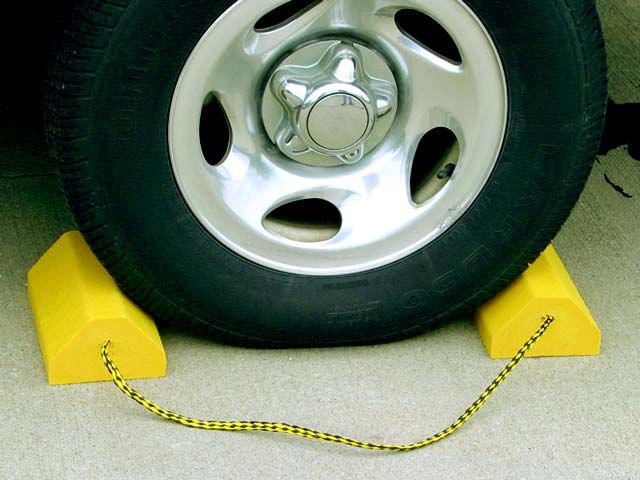

Set parking brake hard enough to actually prevent the car from moving.
Use a set of wheel chocks wedged against the tires on the ground.
These do not need to be store bought nor fancy.
You could easily chop a cube of 4"x4" lumber into a pair of wedges. Make two sets, one for each rear tire.
Also, images failed to load for me.
