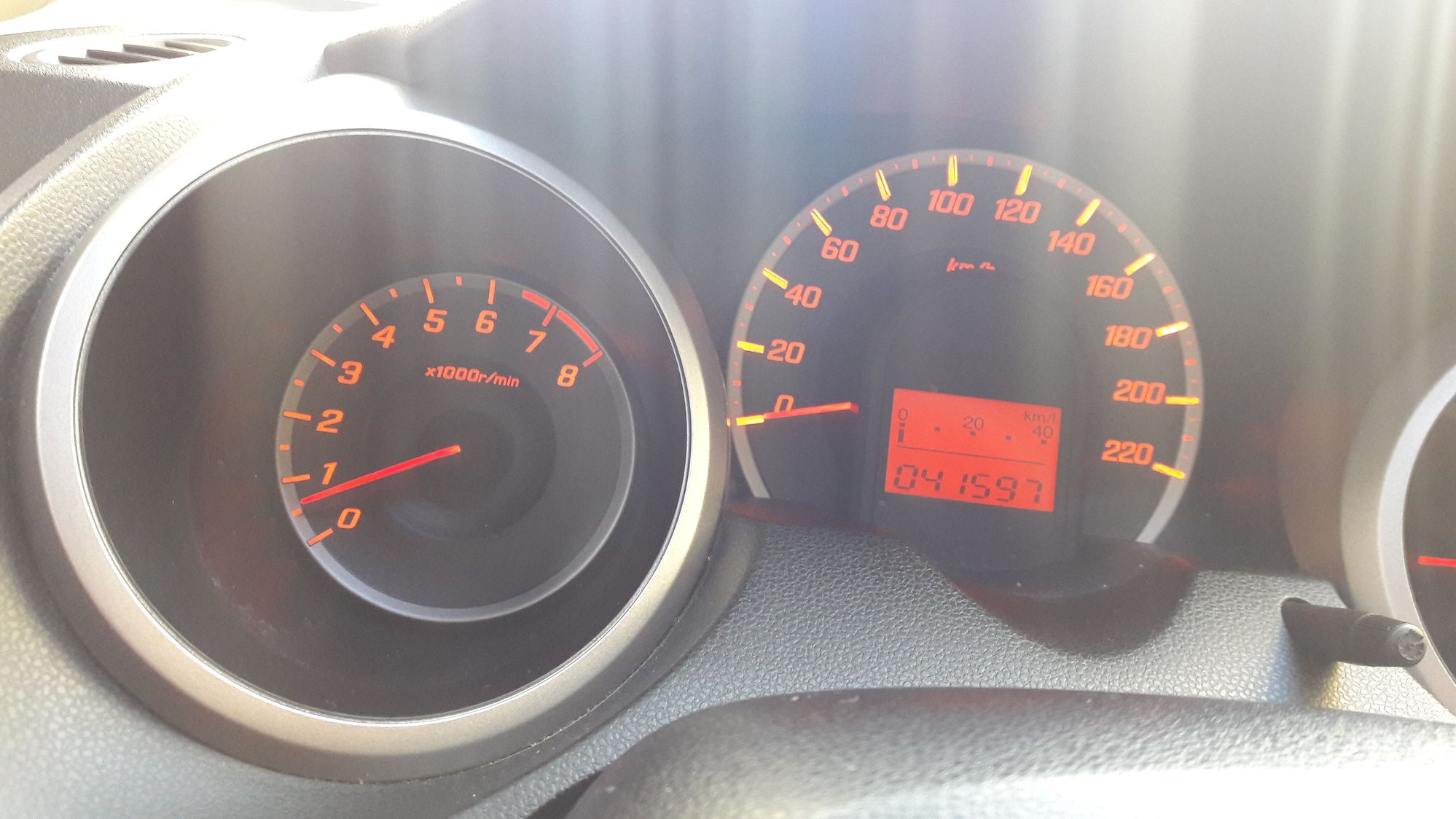

Im having the same problem. Low idle, jerking acceleration,feeling a bit heavy on acceleration. already changed sparkplugs. Havent tried ignition coil yet. Could it be my coil packs?
