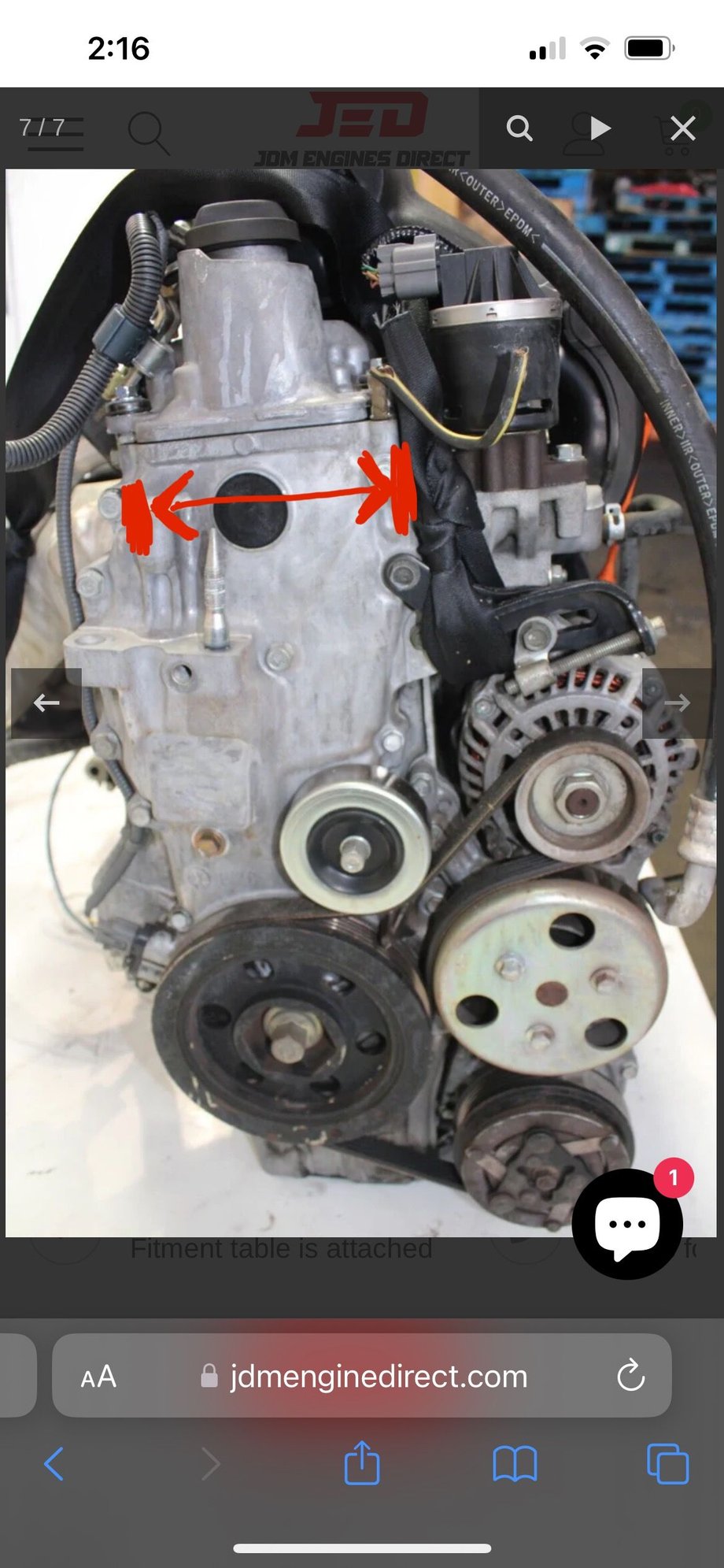

Would anyone be able to grab a couple measurements off their engine? I’m looking for the width of the cylinder head and the width of the intake runners. With those measurements I can scale from some engine pictures and see how tight the engine would be in the mini subframe and engine bay without having to buy one at this point. There is a strengthening rib about mid way up the firewall that the engine subframe mounts to that I’m worried will interfere with the transmission output.
I’m also curious if the GE fit auto trans half shaft will bolt up on a manual tans and engine pairing? Seems to be a good way to reduce torque steer. I will need to make custom driveshafts for my project anyways so that’s not an issue for me. What I’m wondering is if the AT output is in the same place as the MT so the half shaft mounting bracket will still line up with the bolt holes in the engine block and if the AT output is the same as the MT.

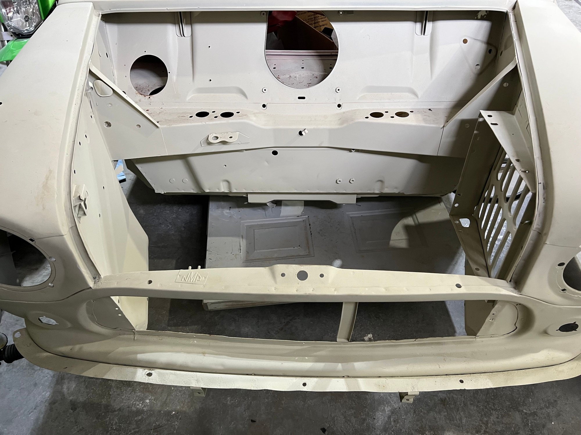

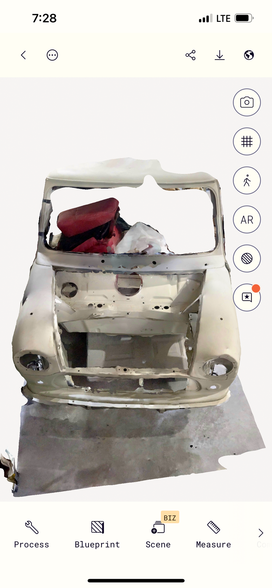

There is a stiffening cross member on the upper part of the firewall I’m concerned will interfere with the GD header. The GE single exhaust pipe may line up with a tapper in this cross member so it may fit better. I would rather have the metal valve cover from the GD but the GE has a little more power, continuously variable cam timing and 6 speed MT.

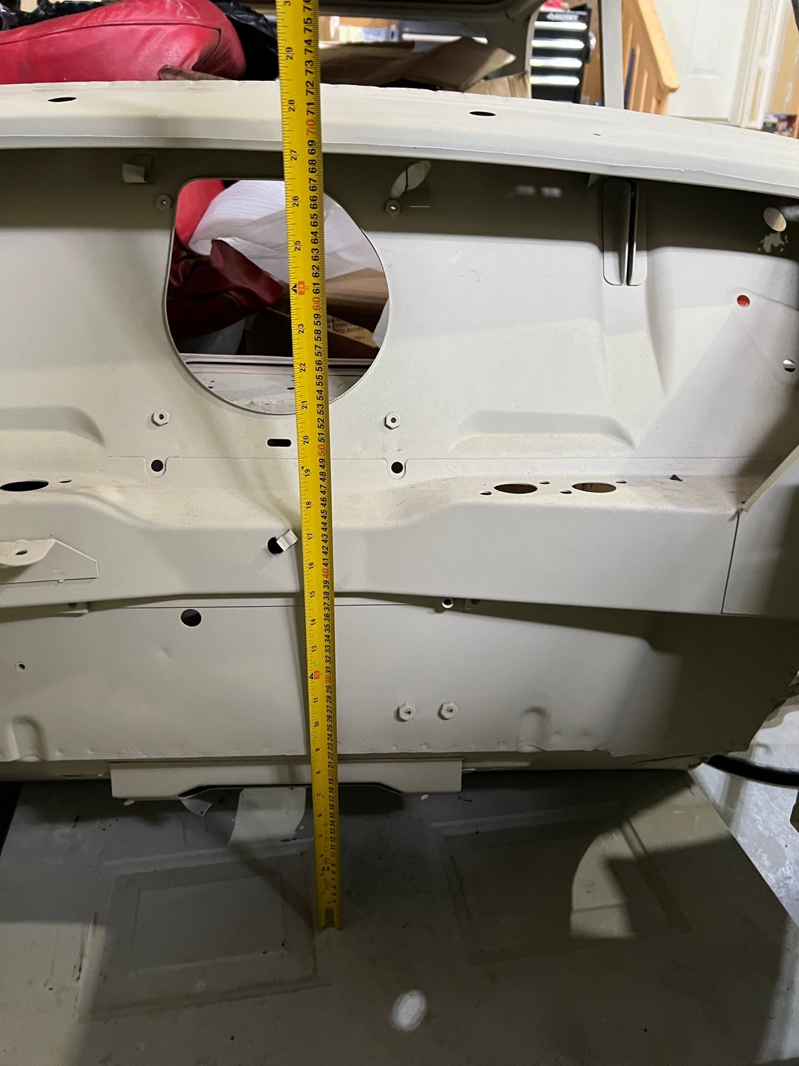

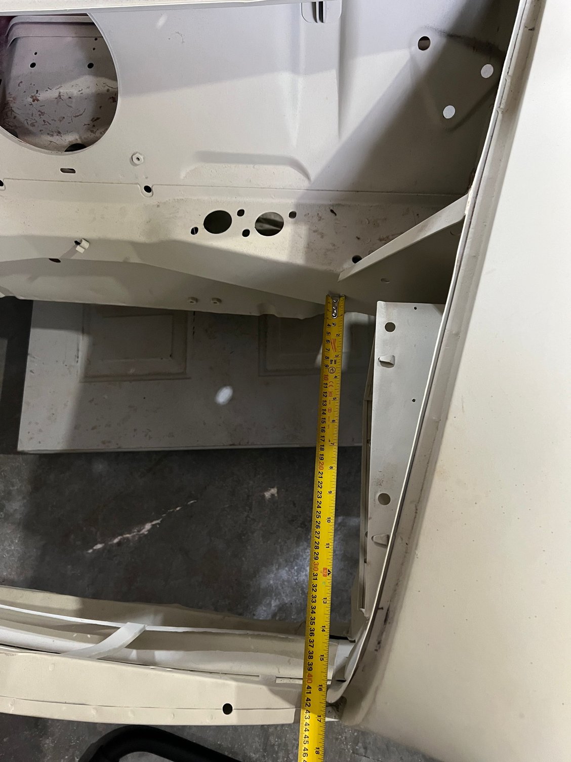

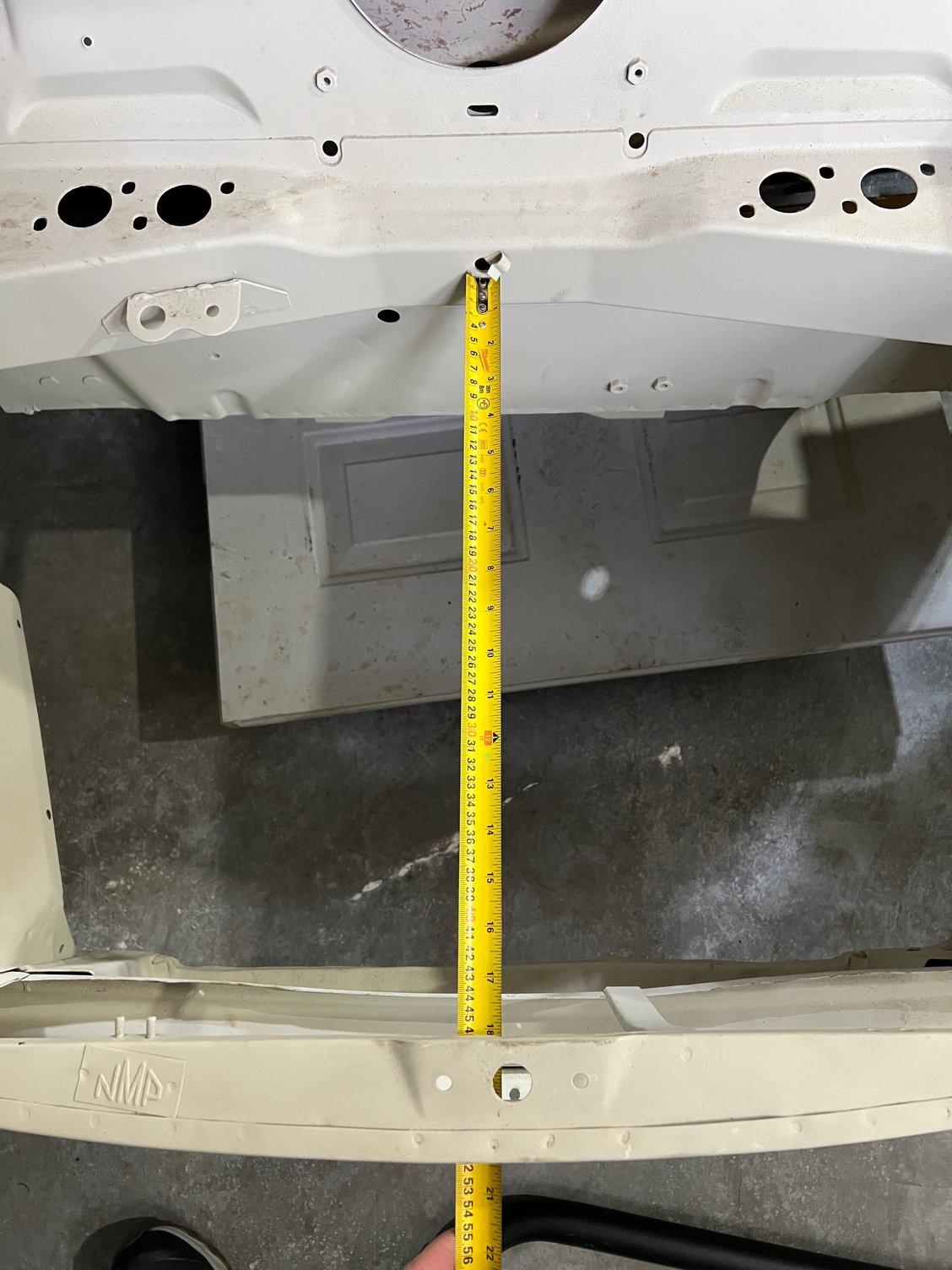

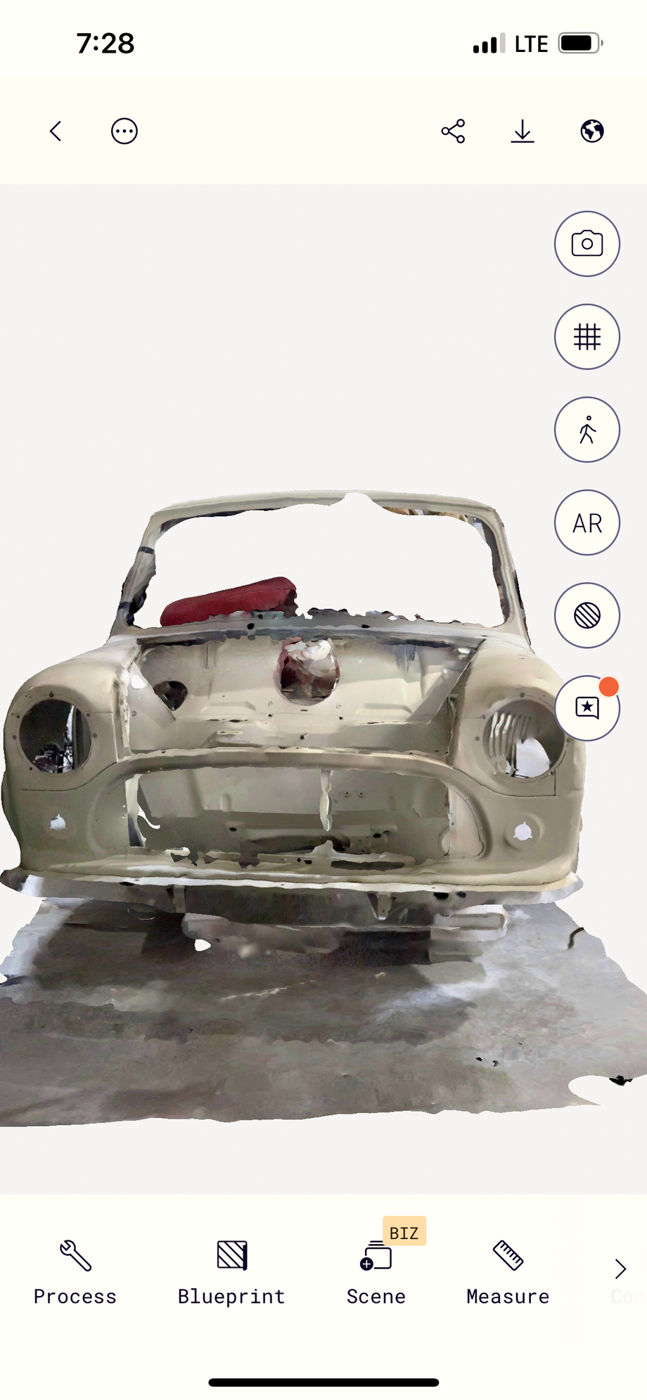

I downloaded a free app called Polycam that makes 3D scans just using the camera and lidar on your phone. I just did a couple quick tests on the car and subframe below. The results are probably good enough to go to the wrecker, scan an engine and see if it will fit in the engine bay in a CAD program.
There is quite a few subframe kits available commercially that allow you to bolt in a Honda B,D&K series engines. Unfortunately they require you to cut up the car and intake manifolds to install them. I’m also not interested in the reported torque steer they produce. I want to try installing an AT jack shaft on the MT engine/trans combo to keep the torque steering to a minimum but compatibility and engine bay space may not allow that.
