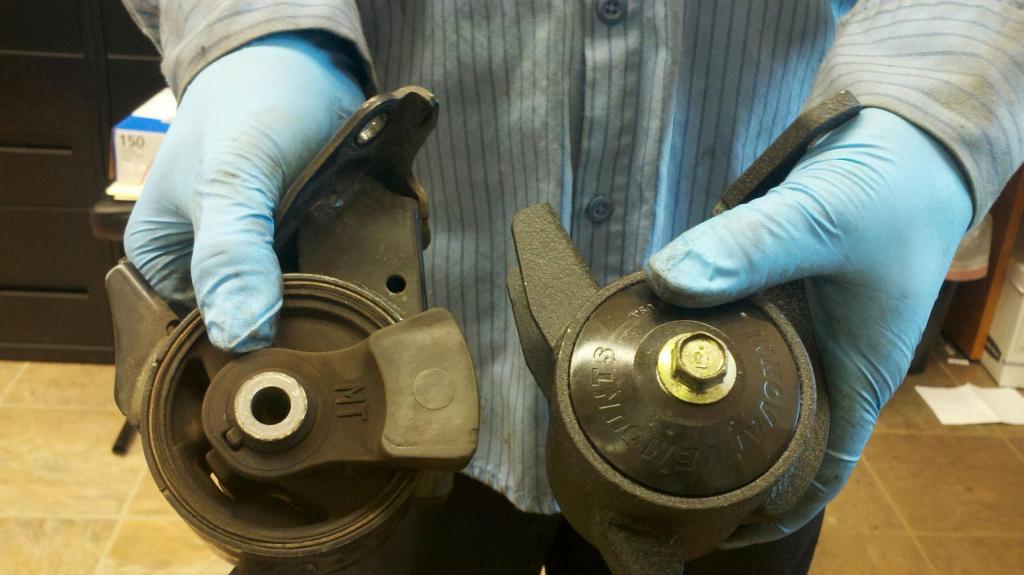

Help!!! Resurrecting Old dead thread, trying to install my mounts on a manual '08 and the tranny mount inner bushing diameter is larger than the OEM mount, allowing slop with the OEM bolt:
It does look similar to the originally mount posted earlier in here:
Can anyone confirm if this is correct/kosher?!
Attached Thumbnails Installing PROTOTYPE engine mounts from Innovative-fdupmounts_zps2ffd3def.jpg
Old Jan 3, 2013 | 06:10 PM
  #56
TPColgett's Avatar
Posts: 1,952
From: Hayward CA
Better photo explanation:
OEM mount with OEM bolt:
New mount with OEM bolt:
Attached Thumbnails Installing PROTOTYPE engine mounts from Innovative-oemwithoembolt_zps720051f8.jpg   Installing PROTOTYPE engine mounts from Innovative-newwoembolt_zps5e5e7a79.jpg

Go to fastenal and get a new 8 or 10 grade bolt... Better safe...

I haven' been able to check it out in person but I was told that this goes into a threaded boss on the side of the engine so a bigger bolt can't be used...

Metal spacer is going to be your only option then... McMaster Carr would be a good place too...

Well, I finally got in contact with a Rep at Innovative. I sent him an Email and my shipping address. He thinks that because I ordered the 75A, they made a manufacturing mistake and pressed in a "standard" type busing/sleeve as opposed to the specific one... waiting on a replacement...
