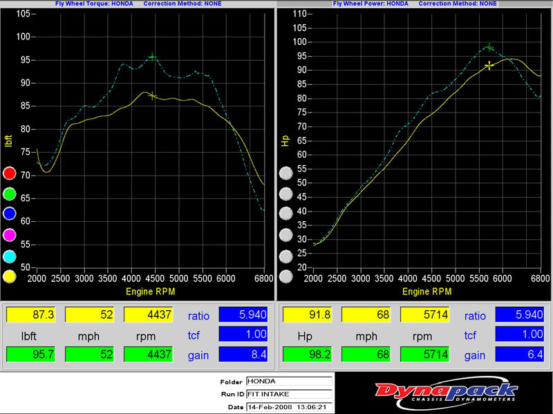

So just looking at the numbers the Weapon R looks better, it makes more power and more torque, however the base graph on the Weapon R dyno is with WR intake and intake manifold installed and then the power gains are with WR race header and "unknown" cat back exhaust, so basically a full header back exhaust so eventhough the WR dyno says it makes more power, it's making more power with more mods.
Now if you look at the top of each dyno chart they say that they are both corrected to at the flywheel, which means that drivetrain loss has been calculated out of the graph, so they both should really be making less power than stated at the wheels, but if you look at this WR dyno (dyno is stock vs. WR intake) which is supposedly corrected at the flywheel the baseline hp is 91.8 which is what everybody on this site is getting for baseline hp numbers so are they really corrected at the flywheel.

Ok, so the tuner in me really wants to believe in the WR race header it's a superior design vs. the J's Racing which still bolts up to the stock cat, but it seems almost stupidly obvious how superior the WR header should be. I'm jacking the pic from vafitfreak's post just to show the differences (note header next to WR is actually Megan racing, but the general size of the header is the same as J's)
Now in his post he said that the gains of the WR header were "amazing" which at first got my blood pumping.
But then I saw that predestyned said that the Megan header only had a little more umph AFTER 5500rpm's, so it shouldn't really be surprising that in this case the WR header felt a lot better.
And then I read 805fitsport say that if a header flows TOO much then adding a cat delete pipe would only make you lose more power.
I guess what it comes down to is do i trust my gut and intuition and everything i think i know about tuning and get the WR for its superior design or do I trust the numbers and get the J's Racing header.
What do you guys think I want as many opinions as possible.
