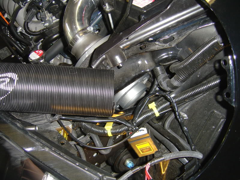

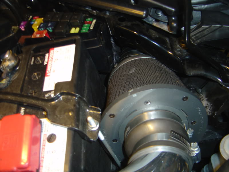

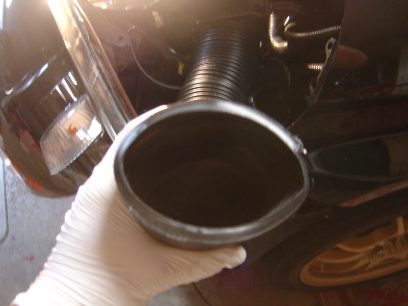

Picture time!!!
So the problem was the "ram kit" WR supplied me with did not fit the hole (by the intake/near the driver's headlight). The ram kit was too big and I could not fit it without some elbow grease.
Here in this picture is how the intake sat normally. I was stumped how that ram kit was going to fit through that hole.

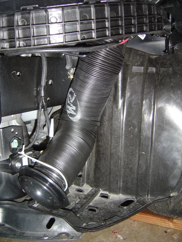

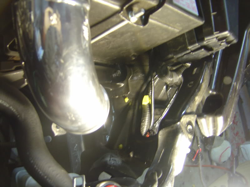

With some elbow grease, I moved the intake and the filter around. Flattened the ram kit a little and it all fit.

Butt dyno = no gains felt
Intake temp did drop 8 degrees according to my scanguage

wow. looks good. if you want a ram air effect take out the drivers side fog light and put the end of the hose in its place. you can expect even colder temps and more air ut you run a slight risk of hydro lock if its raining alot.

petwhookie; Id suggest removing that ziptie and the duct away from the airbag sensor.
Even thought it tapping against it shouldnt be enough force to cause the airbags to deploy I wouldnt risk it.
