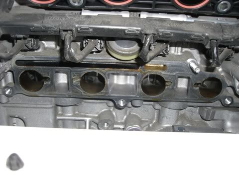

Here's what we did to get rid of the LOW EGR FLOW CEL Light.
Lemme try and explain what we did..
The reason why the ECU was seeing LOW EGR flow was because it needed to flow back into the cylinder head..
Look at the This picture of the USDM HONDA FIT.
EGR gases come from the EGR Actuator ALONG the GROOVE on the Cylinder head.

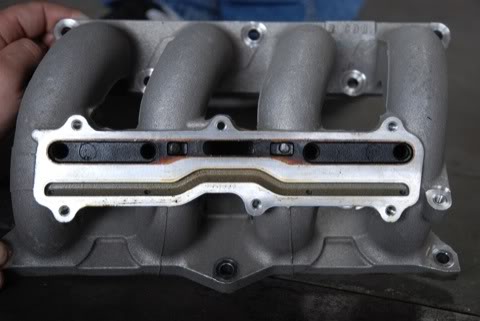

The EGR Gases flow through the BACK side of the manifold.

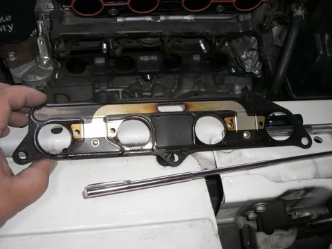

From the backside to the front side of the manifold, and gets re-distributed to the 4 intake ports and back into the engine..
The reason for the CEL with the old design is The EGR gases were not being distributed and the flow wasnt flowing at the rate it was supposed to be flowing at. Now if you look at the picture of the Cylinder head there are 4 wedges that allow EGR flow to flow back into the intake ports..

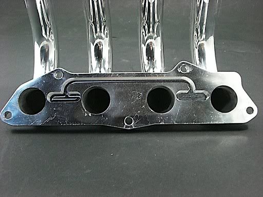

What we have done is Bypass all the flowing through the manifold etc.. etc.. ( PICTURED in pictures#1-3 ) is directly let the EGR gases flow from the EGR Actuator and evenly distribute the EGR Gases back to the intake ports..

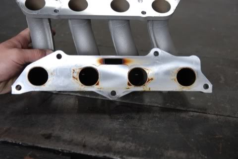

This is basically doing the same thing that the OEM manifold was doing, which is true by looking at an OEM USDM Intake Manifold Gasket..
Flow comes from the middle and then needs to go to the 4 intake ports..
