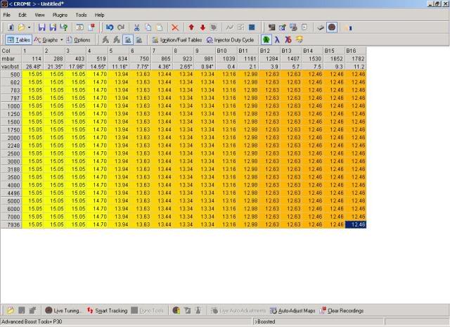

I really want to draw some conclusions about where a "Naturally Asparated" A/F ratio should be. I will start with some basic facts and thoeries....
First we know that the theoretical optimum ratio for complete burn (according to my LM2 Tuning Guide) = 14.7
I understand 14.7 is ok for cruising and idle, but as soon as you start to accelerate it should be lower.
Ok, the next thing we know is VTEC enguages somewhere around 3500rpm and changes the timing... I can only assume that with more compression the A/F target is even lower than without it enguaged.
Right now I am working under the assumption that low 14's are desireable until 3500rpms, then 13.1 is the desired AFR above that. This is what my tune looks like at WOT right now, basically this graphy shows a pull from about 2000rpms through to 7000rpms @ WOT. I will add that I have REDUCED the amount of fuel from the stock configuration even with all my mods to achieve these targets.
I am going to put together a couple of maps for my Greddy E-manage to try out on the dyno as well to see what kind of benifits leaner or richer AFR's yeild.
Anybody want to add or comment here?

12.5-13.5 at wot N/A depending on max power output on the dyno
11.5-12.5 boosted depending on hp level
granted the car will run fine lean...it wont run that way for long....the added fuel cools the cylinders and valves...
here is an example of a low hp boosted honda lambda map that i tuned

What about the lower RPM's (up to 3500), do I want to be in the mid 13's for those or can I keep it in the low 14's at WOT?
Old Apr 20, 2009 | 06:16 PM
  #55
artieman's Avatar
Posts: 408
From: Los Banos, Ca
a/f ratio is dependant on load not rpm....high load = run rich....low load = run lean.....
on that map i posted above low load is to the left and as you push the gas petal down it will move to the right and as rpm goes up it will move down....basicly follow that map
to answer your question under light load like cruising down the street or freeway you can run very lean....but when you punch it at low rpm you dont want to be lean
Old Apr 20, 2009 | 06:25 PM
  #56
Sugarphreak's Avatar
Push My Button
Posts: 4,997
From: Calgary, Alberta
Gotcha,
Basically I will want to try and run a nice smooth 13.1 then all the way accross (I heard 13.1 is the Fit N/A Special )
