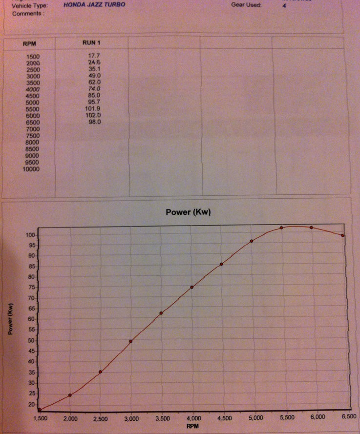

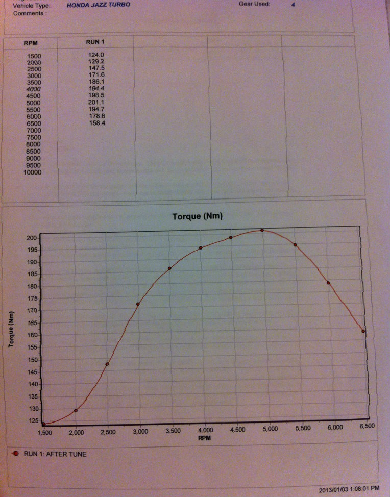

So I got the final daily drive tune done. A very conservative 0.35bar or 5psi boost on pump 95, no water/meth.
That sees just over 40wkw gain over stock and just over 75wnm over stock. Could easily do around 130wkw on 0.6bar but for the sake of the OEM rods the boost has been cut back.

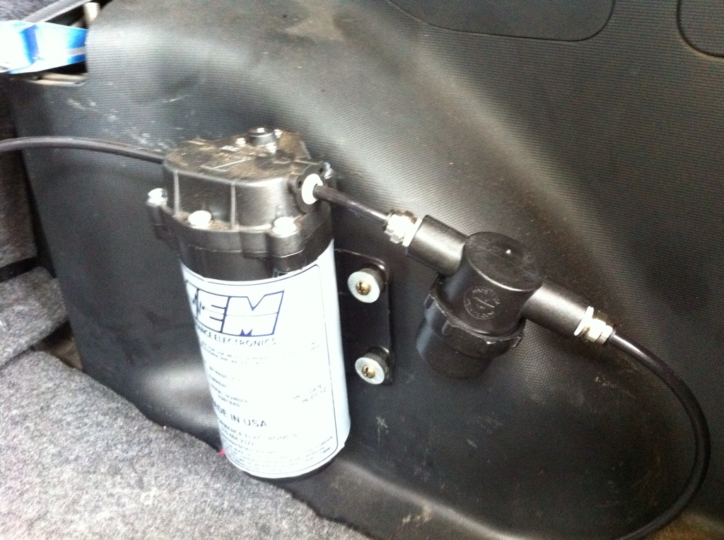

Water/meth inline filter fitted:

Liking the AEM kit a lot! Running straight distilled water for now on the smallest nozzle, gonna do a 50/50 mix in the near future when my full-on engine build picks up some momentum.

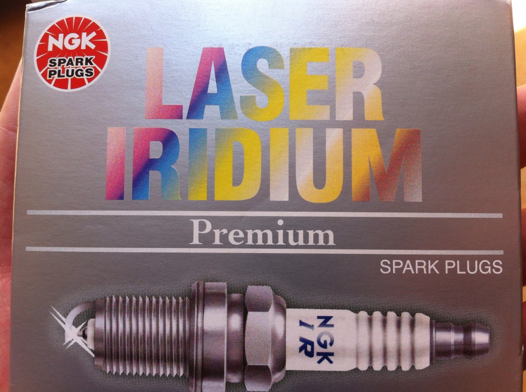

Changed over to these, gapped to 0.6mm

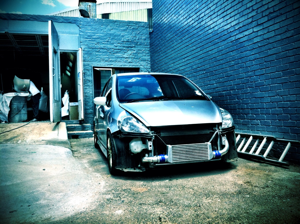

Thanks! I think I prefer the cleaner look, the pointing and staring at the intercooler by random people didn't get old though.
She's running great! Surprising quite a few cars/people on the low boost. Can't wait till my engine build picks up some momentum...

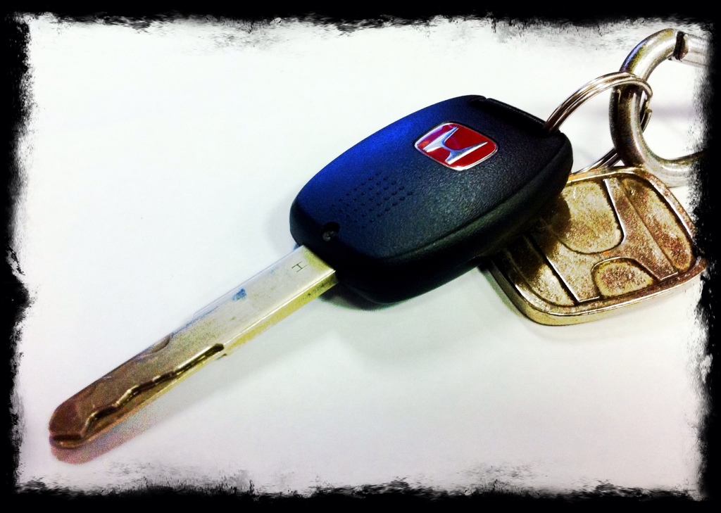

Got bored at work yesterday, took a pic of my keys (yes it was particularly slow day)

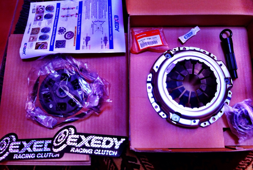

Picking up some slippage from the OEM clutch, which isn't bad considering I've done 135 000km's on it. About 5000km's of which was boosted.
Replacing with this Exedy Stage 2 Racing Clutch:
