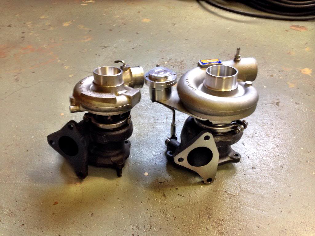

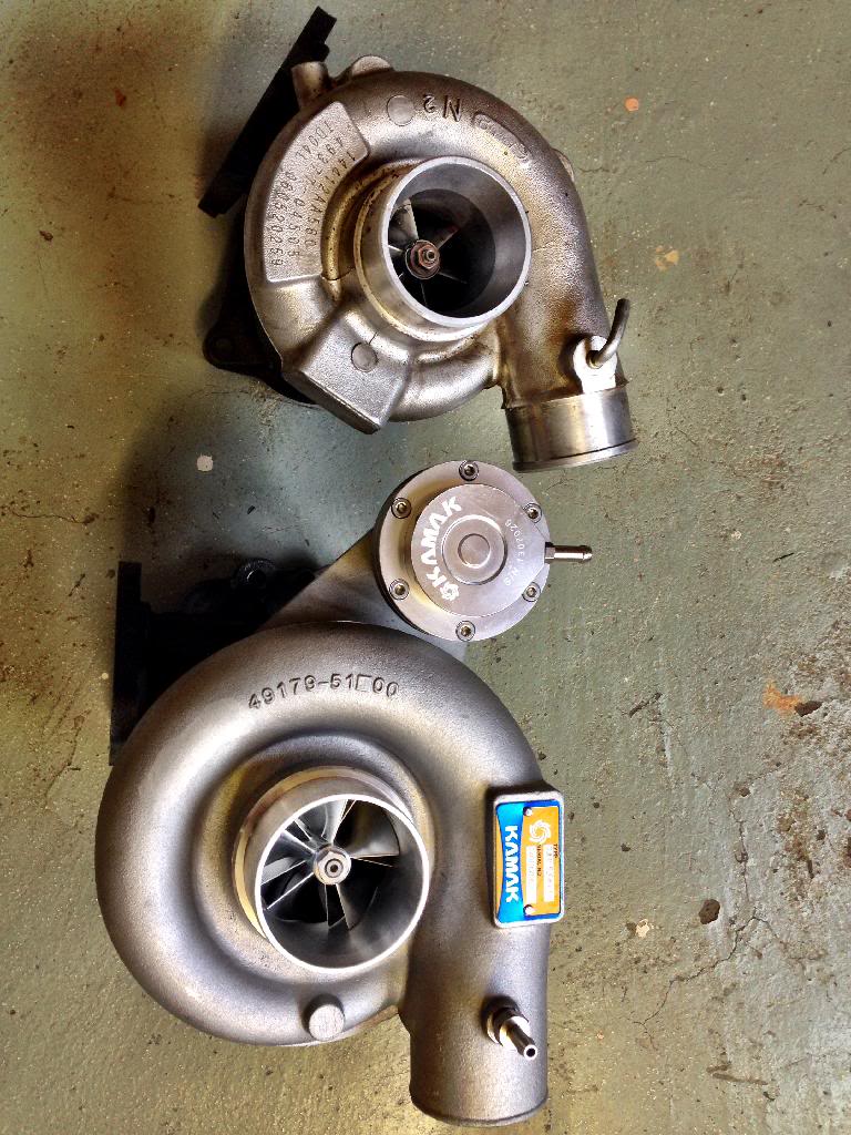

Here's the size difference between a Mitsubishi TD04 and a Kamak STS TD05-20G GTX

Beautiful. I'm working on fitting a td05-16g to my spare l15a now.
When will the 20g go on the fit?
20G is going on my other car
TD04 is still good for 1.2 bar of boost, which I'd like to make happen next year

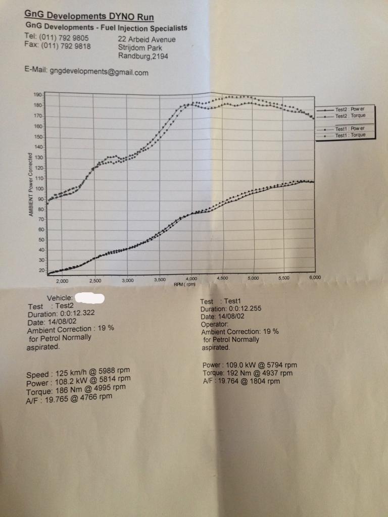

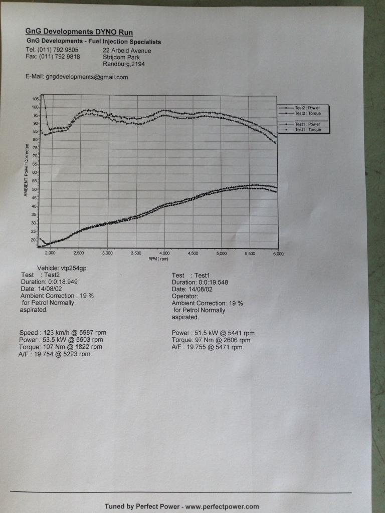

Dyno run at Perfect Power in Johannesburg. For reference a bone stock GD3 1.5 VTEC made 51.5wkw and 97wnm, I made 109wkw and 192wnm

Something like 146/141 wHP/wTQ
Niiiiice!
Did you get a sheet you could post? I like to see the "under the curve" LOL
Niiiiice!
Sure, here's my graph...
Here's the stock Jazz...
For reference, a DC5 Integra Type-R made about 3-4wkw more than me but I made 42wnm more than that. An EK9 there only made 92wkw.
Saw a modified Fiesta ST make about 120wkw.
