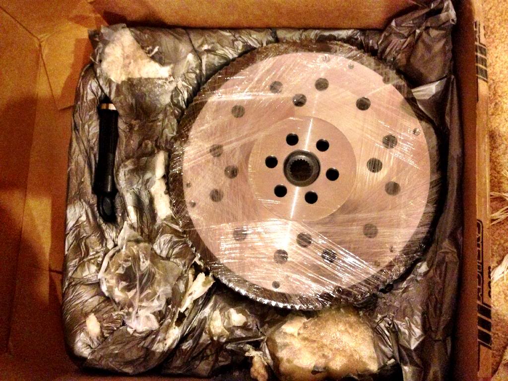

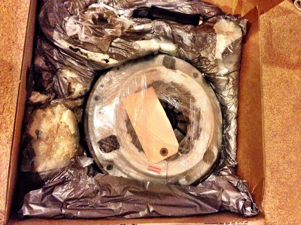

Hmmmm, not sure why I kept on saying I was getting an ACT clutch when I actually ordered a Clutch Masters clutch kit and flywheel...

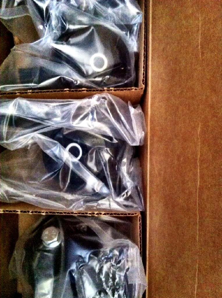

Well one of the hold ups is the previous workshop managed to strip 4 of the 6 flywheel bolts. Picking up a new set from Honda on Monday. ARP was a little confused when trying to order a set from them for the Jazz...
The other hold up is one of my engine mounts is broken. Soooo I ordered a set of Innovative mounts (75a).

Ahh.... the Innovativemounts are NOT a simple . My trans mount had the wrong sized center shank, and the bracket for the passenger side just did not fit AT ALL. I ended up retrofitting the innovative bushing into the stock mount. Once I finally got them in there, SO worth it though!!!

Thanks for the tips, will see how it goes, hopefully I'll have better luck.
They arrived so I should be getting the car back next week

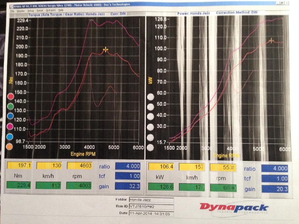

The printer couldn't handle the dyno sheet, luckily all the important bits are legible :P. For reference, the initial line was when I dropped the car off. Pretty shocking I know.
2nd line (Red) was after the initial bugs were ironed out.
3rd line (Pink) is the final result on 0.6bar boost with adjusted timing and fueling where necessary. No detonation and MUCH smoother than before.
