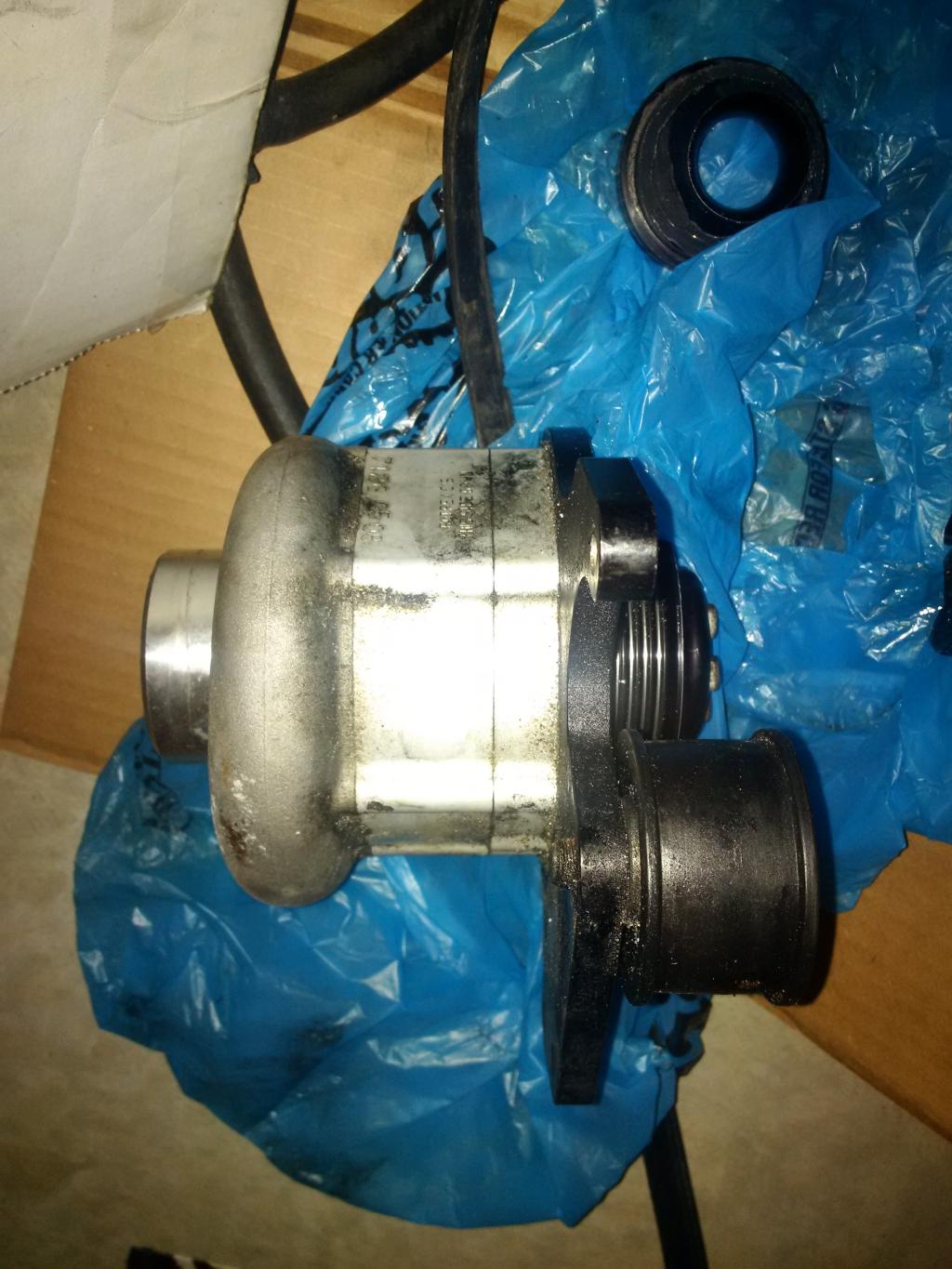

I recently picked up a used KWSC kit from a FF member. Seller had explained that he had the belt snap on him twice before he removed the kit from his car. When I received it, pulled it out of the box, super dirty and oil residue all over it. When I hold it in my hands and spin the pulley about every three turns I get a tight spot enough that with the oil residue on my fingers I almost can't spin it.
Now I have heard that rotrex charges have a planetary gear set which apparently will have a tight spot. Can anyone else confirm whether theirs had a tight spot as well? I'm nervous that this may be from the belts snapping due to incorrect tension or misalignment and have bent pieces inside the charger. Or possibly this is normal and just needs to have some oil run through it.
I have experience with turbos but never have I dealt with superchargers, so I don't feel terribly comfortable pulling this one apart. Have heard of local shop here that is a turbo/supercharger shop that can inspect it and definitely have it cleaned due to it's atrocious condition.

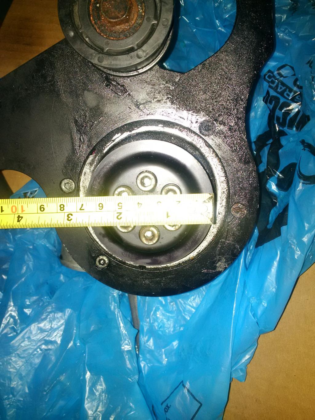

EDIT: here's a picture of a measurement of my pulley. As you can see I received it in PERFECT condition...
