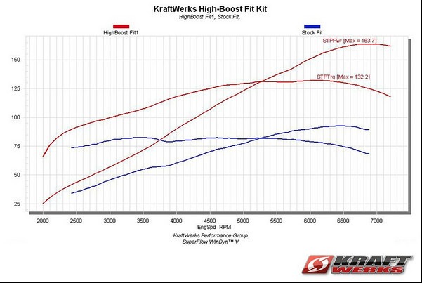

Kraftwerks sold out of the kits a year or two ago. Other vendors may have some laying around. They also had a graph somewhere on their site showing the naturally-aspirated and forced induction curves. I think the high boost made something like 130hp or so?

It is 73HP over stock at the wheels
Keep in mind that was on the stock header and a catback exhaust at most... plenty more to be made with additional modifications and tuning through a flashpro.

I emailed the inquiry email for KraftWerks on 06/29/2013 about not being able to find the kit on the website anymore, stating
"I am interested in purchasing a supercharger for my 2007 Honda Fit (GD3) and would like it to be from KraftWerks. The problem I'm running into is that, while I know KW produced a supercharger for my application in the past, I am unable to currently find any information on it on the website. Am I an idiot who sucks at searching, or has this information been scrubbed from the website?"
I received an email on 07/02/2013, stating
"Rest assured you do not suck at searching, that kit is not listed on the website because it is discontinued and we only have 1 left. The one we have left is for 07-08 manual high boost kit which cost $4495 plus shipping."
I had additional questions and was told this in response:
"Also the high boost kit with our tune on a stock vehicle made 163who and 132wtq. The only recommendation would be to upgrade the clutch to hold the power created."

Yes, 163hp at the wheels over the 90hp at the wheels the car made stock on their dyno in their shop is a 73hp gain. I've been there multiple times and been on the dyno before. Clutch master stage 3 has been holding down just fine for 40K.
