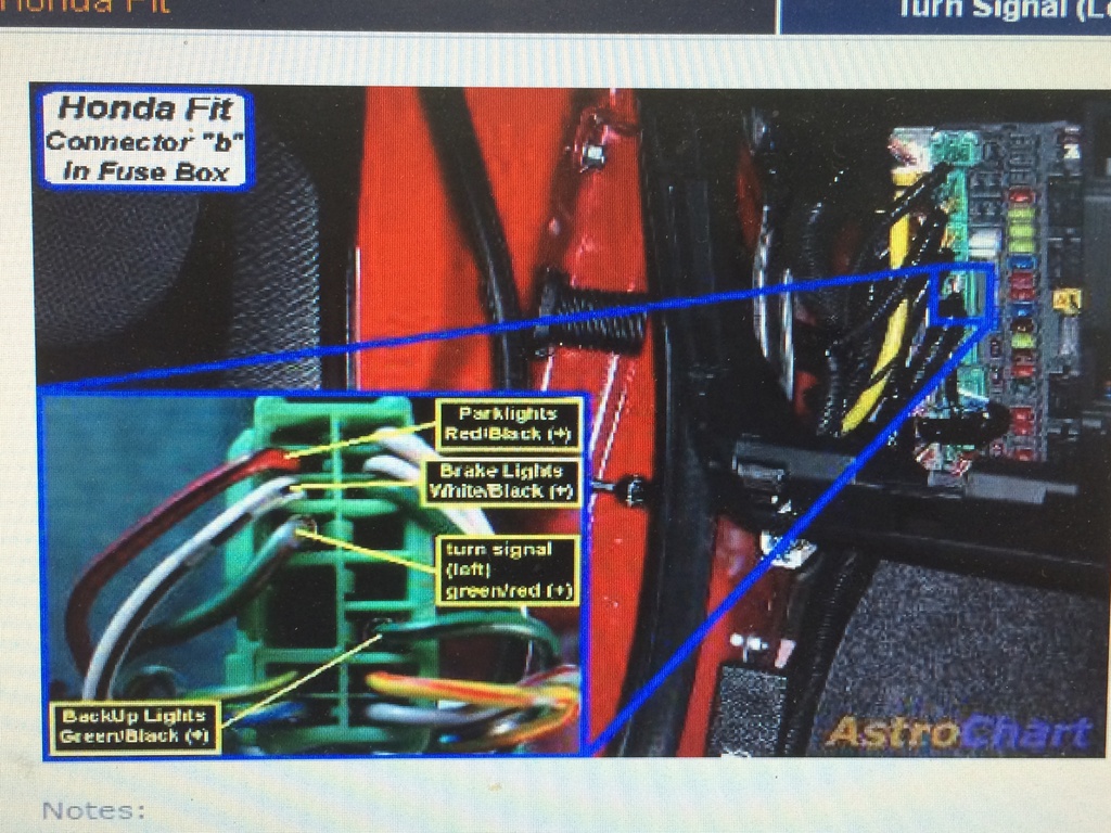

So yesterday I installed and wired up my gd3 power folding mirrors on my 07 honda fit sport. Only have to wired up the marker light now for mirrors. Were can I get the marker light signals for the mirrors by the fuse box plugs wat wire is for the left side and for the right side signal

I spliced the front signals for my mirrors marker. Hope this help

There's a wire down by the fuse box for signals. I'll see if I can dig up the paper tomorrow after work.
GRN/RED for left
GRN/YEL for right
