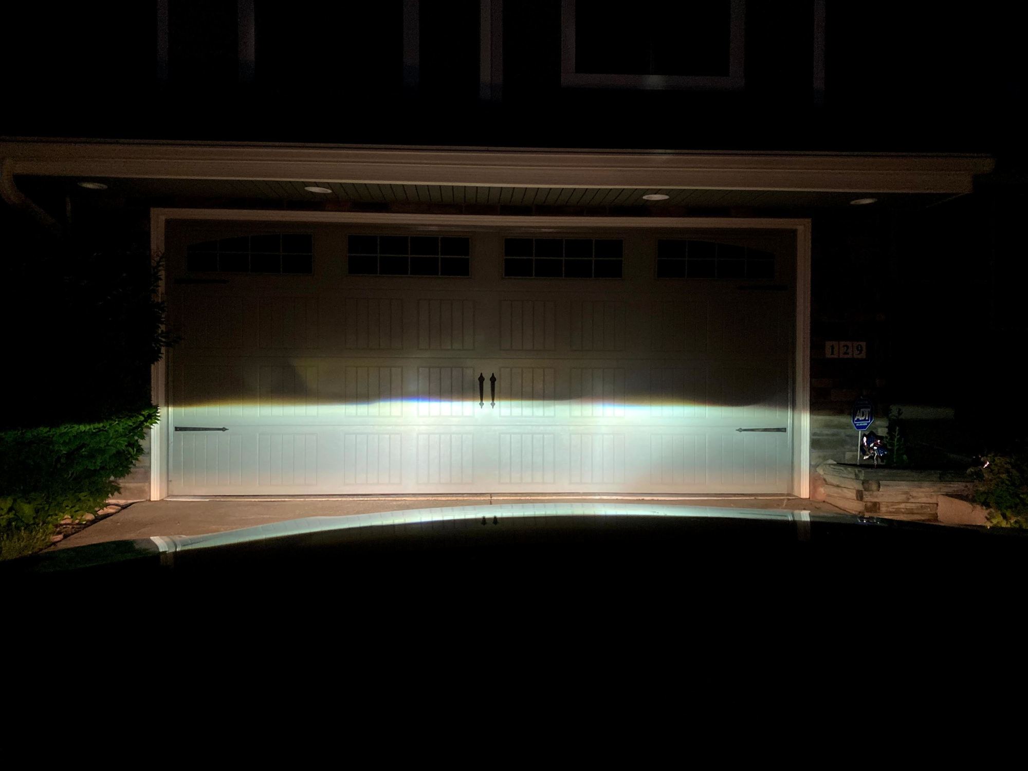

Here are my Morimoto 5K HIDs in my 2015 Accord EXVL Coupe with factory projectors for comparison - very happy with the way the Katanas turned out! I wasn't expecting such a sharp cutoff from LEDs and reflectors:

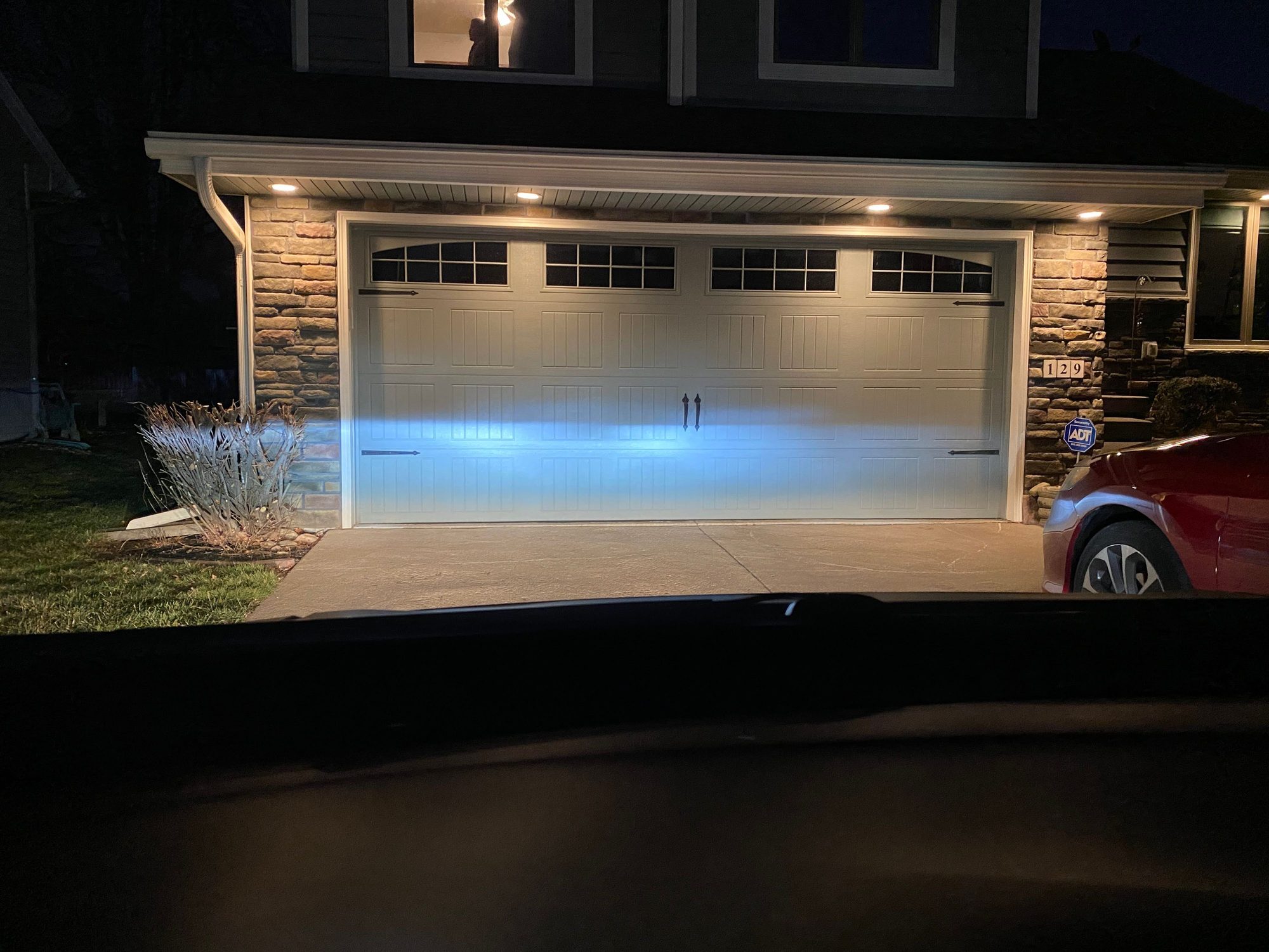

My wife and I feel the light output is better than the factory halogens and she was hesitant to drive it at night before installing them. Her last several cars have had OEM HIDs and she’s happy with the output. However, I don’t believe LEDs have the same output as HIDs and certainly can’t throw the light as far - I assume that’s why Honda uses multiple lights for their OEM solution.
Below is a picture from tonight against the garage door with the exterior house lights off. There’s also a quick video I made of a drive around the block if it helps. And, for the price and Amazon’s return policy (coupled with an easy install) it might be worth getting a set for yourself to try.
