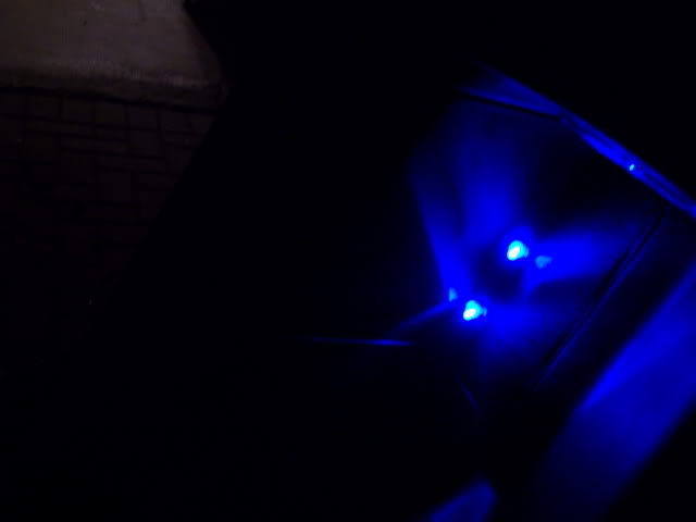

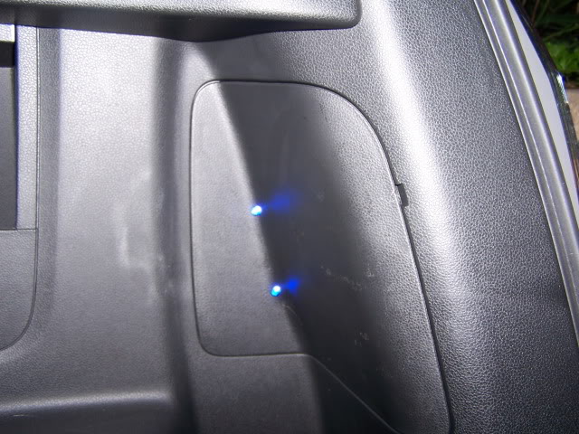

Here are the pics.
With flash on
Flash off
They are bright enough I can see them shining on seat back.
I bought my LEDS at WalMart. Four in a pack for about $10. They each had about 2 1/2 - 3 feet of wire attached. No holders. I drilled holes so that they are press Fit. I bought all the wires together in the middle and soldered to a piece of speaker wire I had kicking around. I snaked it up to existing light fixture. I removed bulb and used spade connectors to attach wire.
Snaking wire tips. I used piece of coathanger with hook bent on the end. To get a new wire from exisiting light down to taillight hole I went up through tailight and fiddled til could see end at light hole. Just looped wire over and pulled it through. Remember to hold one end. Then from hole around tiedown I snaked up to tail light hole and hooked wires on and pull down through tiedown hole. Lift up center piece of trim that is in the middle enuf so that you can snake coathanger up to tiedown hole and hook wires on and pull through. Do same on other side. You should end up with all four pair od LED wires and the new wire going up to exisiting light. match them up and solder and tape or shrink wrap.
