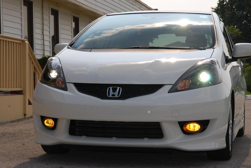

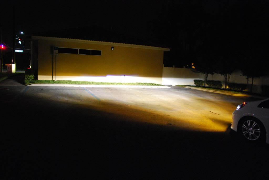

I highly recommend PIAA 3000k HALOGEN bulbs for the foglights. Putting HID in the foglights actually produce more glare since they aim slightly up compared to headlights which aim slightly down. The halogen bulb will not fail on you like the crappy pnp HID kits will. Heres a picture of my car with PIAA yellow in the foglights. They are very bright as you can see and do not blind oncoming traffic since the waves coming off of a halogen bulb react different than a xenon bulb, which the reflector housing is designed to work with.
