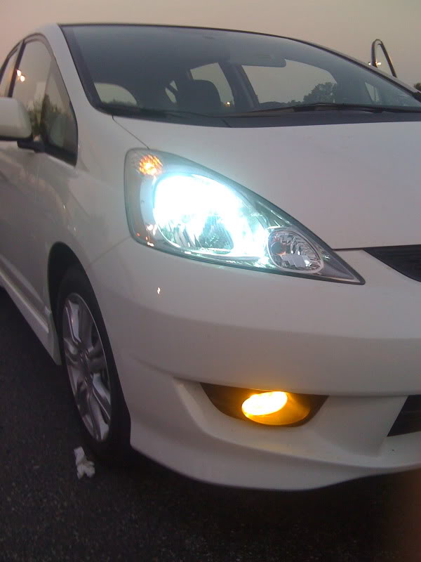

I have HID on mine. It maintaines both Hi/Lo and DRL. it is PnP kit.
There is an after market for 2009-10 Honda Fit headlights. It separate headlight into 2 beams, Hi/9005 and Lo/9006. Low beam is a projector. So what you have to do is to swap the blinkers with parking light. Use LED as High beam.
