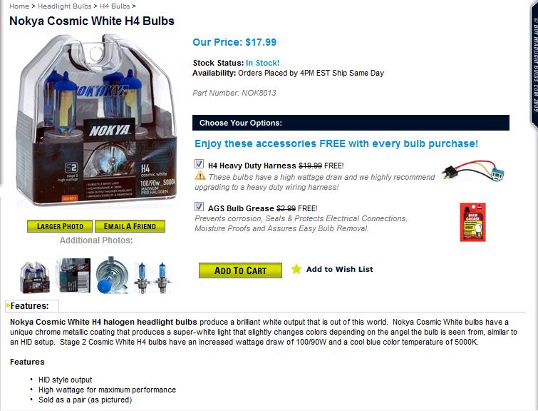

Hello I up to get high wattage bulbs 100/90 but I was wondering if this plug and play harness will be ookay to use with it. I been searching but I haven't found any threads on this forum or others.
here is a picture of the bulbs and harness

Where is this screen cap from?
I've always been skeptical of h4 harnesses...mostly because the demo video is kinda misleading in how they are showing the heat resistance.
I also just though the heat would feed into the stock wire anyway.
Perhaps I'm not understanding something.
Maybe I'll just buy those bulbs and harness and report back to you? I've been looking for some more output.

I hope that's not the picture of the actual harness. Because that's not a harness. That's an extension! You're still drawing power from the factory power source through the stock wires.
haha yea what he said...
The only way I see that working is that the connector is a little more heat resistant. 100/90w bulbs may be a bit hotter vs stock and the stock connector cant handle the heat and my warp, so with that extension you move the stock connector away from the bulb and you use the heavy duty connector on the 100/90w bulb.
Thats my wild guess as to why they include that extension/harness
