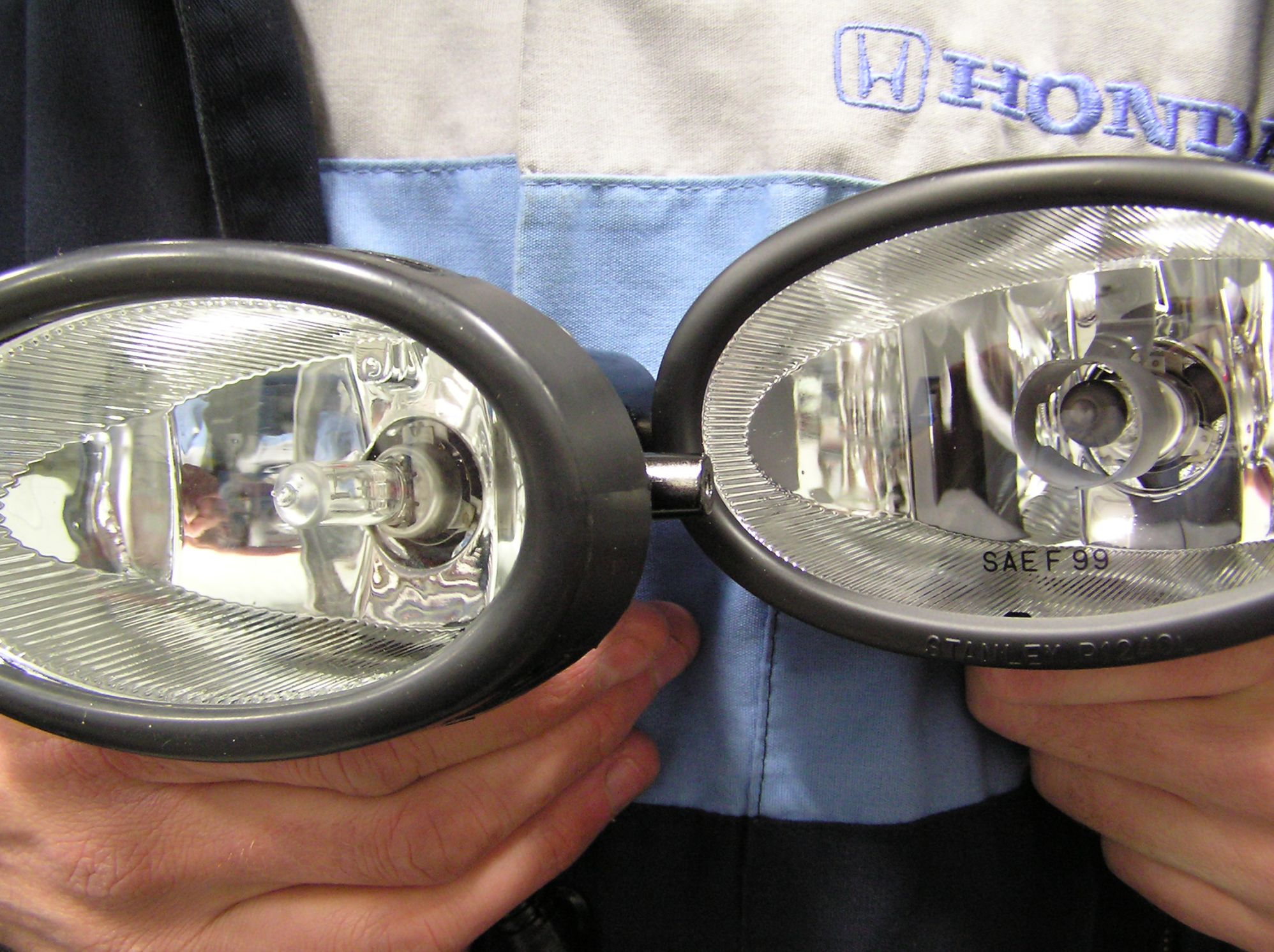

(or even better, had the OEM then equipped aftermarket ones to compare)?
You get what you pay for. Sometimes you don't even get that.
Not Fit specific, but these were for Hondas and I have pics
Side by side comparison from a couple years ago..
One is from a set of NOS Honda accessory fog lights a coworker had saved to put on his own Accord, these were actually for a CRV and could fit some other models if one had the right brackets....
The other is from a cheap set he found on the internet. ALMOST a clone of the Stanley, but really a lousy knock-off.
Notice the reflector around the tip of the bulb in the NOS
The actual SAE number on the NOS lens
The name STANLEY and part number on the black trim ring
I didn't get pics of the backside of the units, but the Honda one has the name HONDA and STANLEY molded into it.
Knock-off says HONG YUAN on the back.
Also not pictured, the gaps in the sealant between the lens and body of the aftermarket unit. Looked like it would eventually get water inside and ruin the bulb prematurely or corrode the reflector.

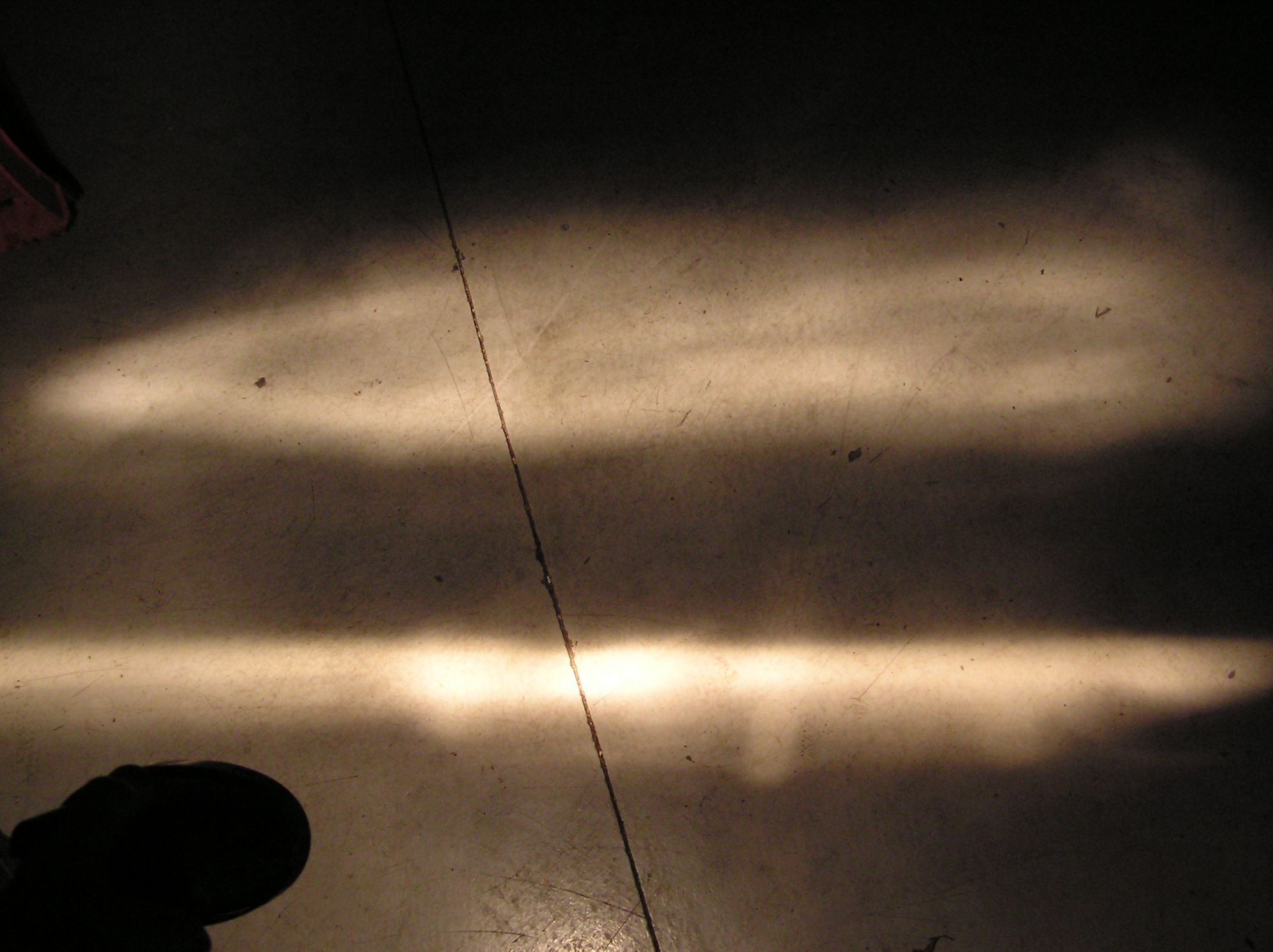

And the most important part that counts, the beam:
the top one is from the knock-off
Bottom beam is from the Honda unit
These were just held about chest high and pointed at the shop floor, powered off a car battery.
Aftermarket units beam on top. Looks more like a floodlight to me. If there was really any fog, it would suck as a foglight.
Honda unit on the bottom has a nice wide, almost perfectly flat beam with sharp cutoffs and the hot spot in the center.

Thx Ezone, getting to actually see the difference is quite useful.
It eliminates all cheap options
