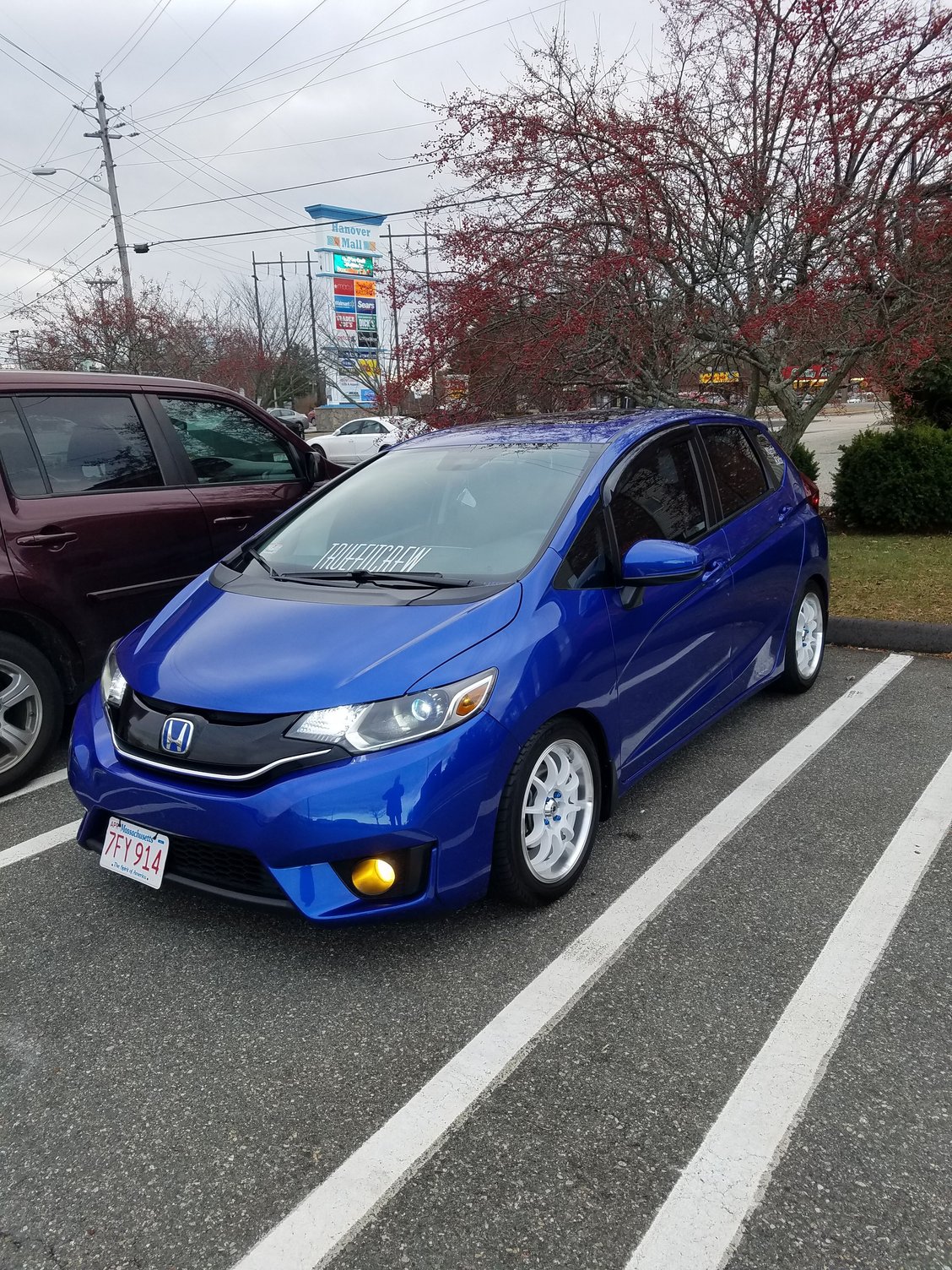

Old Dec 18, 2018 | 10:41 PM
  #140
CodemanGK5's Avatar
Joined: Jul 2017
Posts: 61
From: MA
DIY Mini H1 projector retrofit was one of the first and best mods I've done to my GK. Well worth the time and effort!
