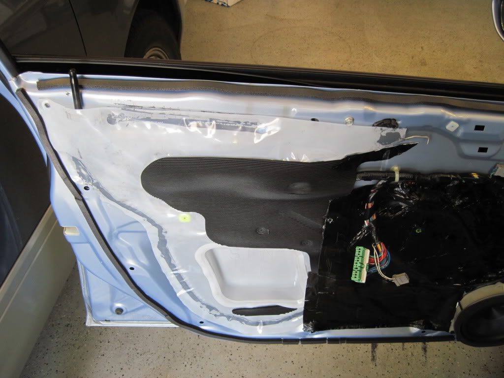

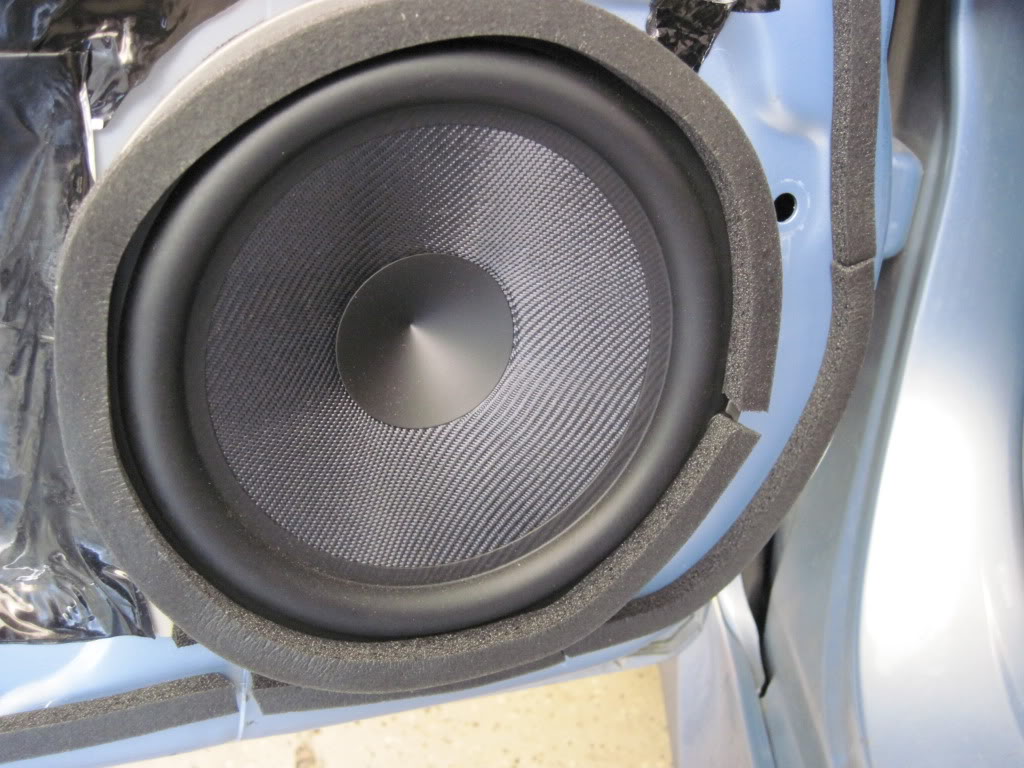

to those of you that have opened your door trims off a millions times (like me)... some of the clips will not close with the added thickness but still, i can live with that. The bass now is MUCH cleaner and vibrations didn't disappear but they are about 80% decreased! Was it worth 7 dollars and an hours time? HELL YEA! you'll need 2 sets or 20ft of that foam tape, its JUST enough for two doors, 20 feet probably if you wanted to do the rear doors as well.
I'd also recommend screwing your speakers into the door with self-tapping screws. Just in case those bass-heavy notes want to move your speakers around. Overall i'm pretty happy!
Steps!
1. Remove door panel and get it out of the way (SPORT MODEL GD FITS, BECAREFUL OF TWEETER WIRE!)
2. Apply foam tape around the speaker to ensure a good seal between the panel
3. Apply foam all along the door where the panel meets the door frame
4. Also do a strip along the top where the window is (you'll see it)
5. with the remainder, add some anywhere you think it might vibrate, if you're REALLY anal about vibrations, just pick up extra foam and go crazy!
