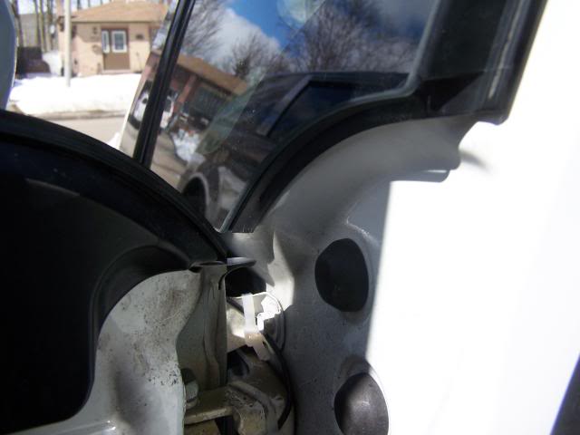

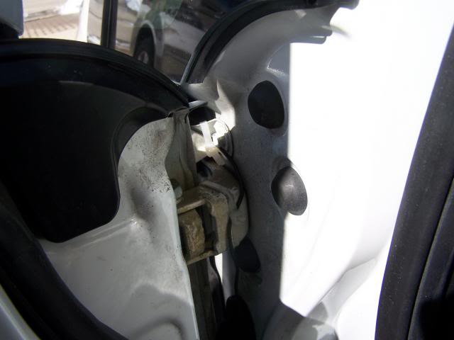

I am not sure where but some have found a grommet down around steering column where they pushed another wire through. I was able to thread one through the top inside of fender. You can see it with door open just above the hinge then down into interior. THese wires come from my white gril lights to the ACC circuit.

THe black wires are ones I threaded through.

I couldnt find that grommet by the pedals, so i think im going to use your route through the top of the fender. Still pretty tricky to see in there, did you have to remove anything to get your wire through there? Im going to take a second look tomorrow, maybe use a coat hanger to push through.

I used a coat hanger to pull the wires through form engine compartment.

Poked my way through with a coat hanger fairly easily. Started from the top of the drivers door hinge and worked my way into under the hood. Taped my wires to it, then pulled it back out. I took some horrible pictures, you can see the two wires taped together, and the ground wire under the bolt right by the speaker (says 12V).
The wires snake into the car and are glued just under the window so nothing pops out when the doors open and closes. Mounted my little controller in the empty spot beside the mirror controls. Unhooks easily and looks good! Thanks for the help Black3sr!
