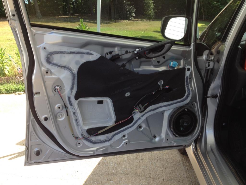

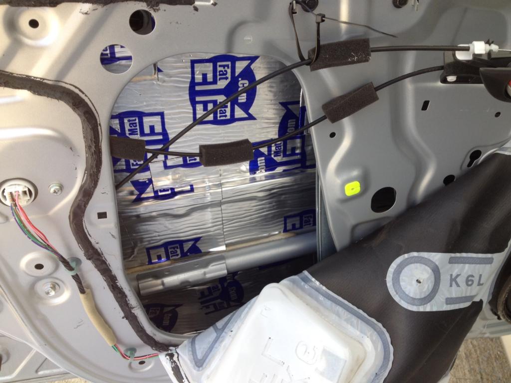

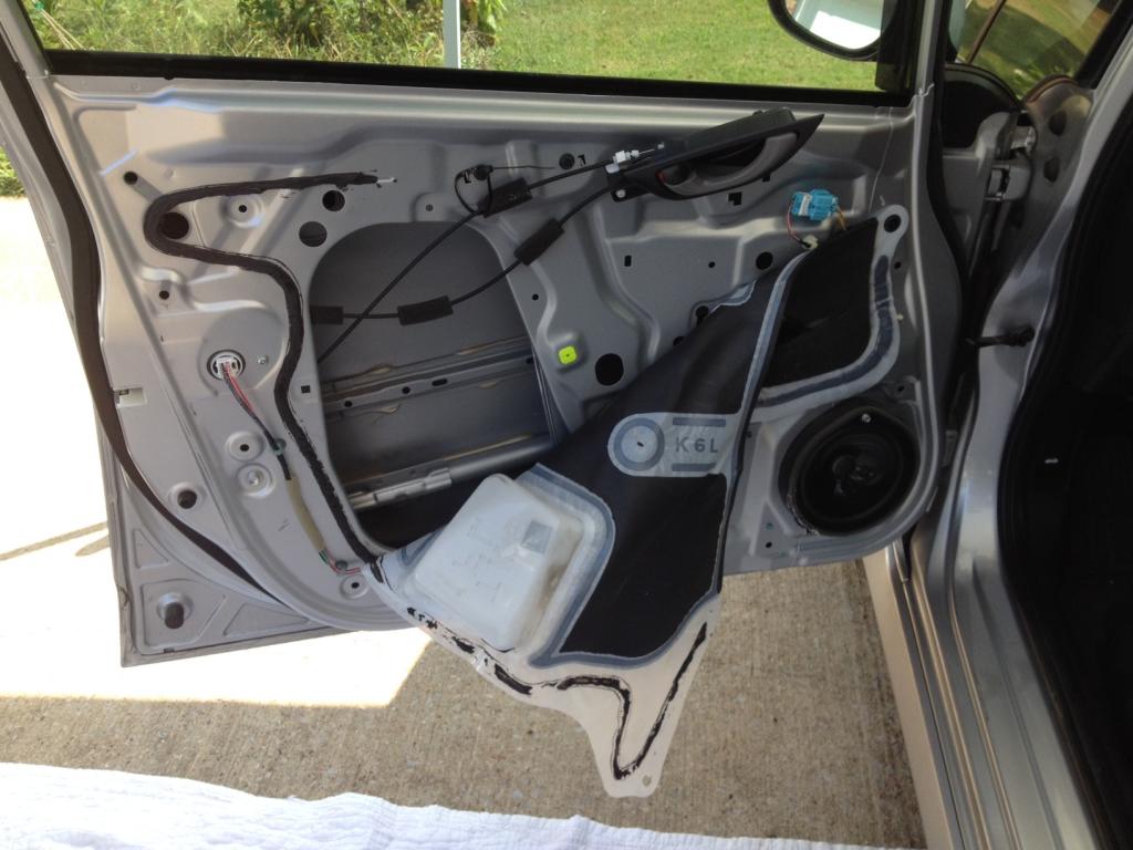

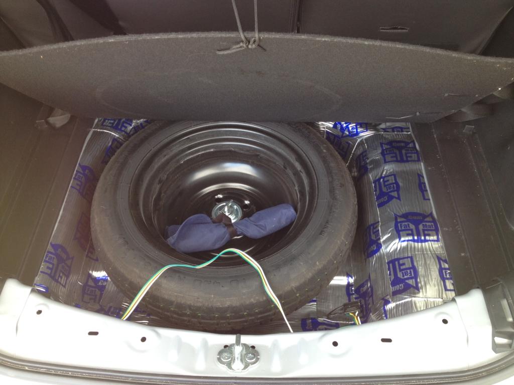

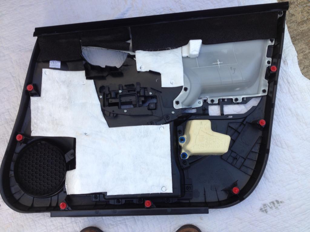

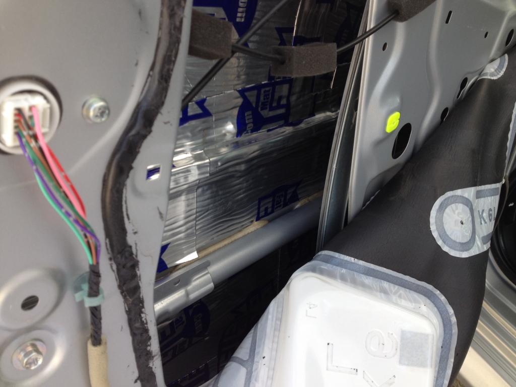

I was finally able to install this in the front and rear doors, behind the kick panels in the front, and in the spare tire well. The road noise level in the car has been greatly reduced and the radio even sounds clearer and a little louder. I actually had to reduce the treble a notch to get the same sound.

Just a couple of notes from the install:
- I found this to be an easy project, but very time consuming. I have about 11 hours in it so far and still need to install over the rear fender wells and possibly the hatch. About 6sqft of the 50sqft roll is left, so the 50sqft roll seems perfect as long as you're not removing carpet or the headliner.
- The kit came with a small razor knife, but I found that it was easy to cut with a pair of scissors. The ones I used were stainless steel for $1 at the Dollar Tree.
- The material is much easier to fish into the tight spaces in the door panels when cut into ~4"x6" pieces. You can see from the pics that I did a lot of piecing together and overlapping.
- The adhesive on the back of the FatMat is extremely sticky. As long as the metal surfaces are pretty clean I don't see how this stuff would ever come loose.
