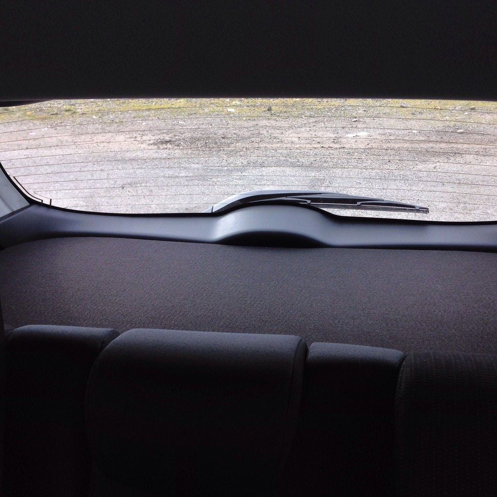

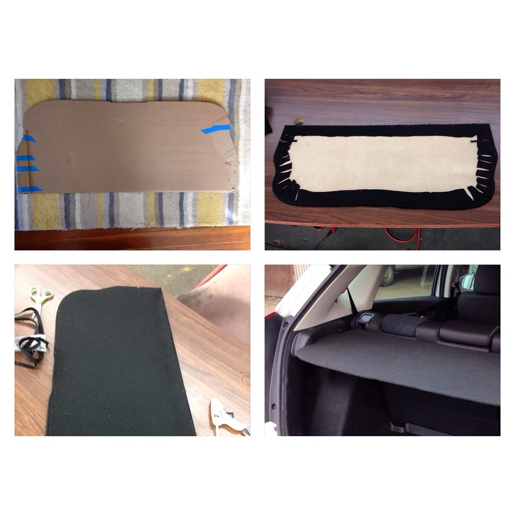

Today i made my own cargo cover from hardboard and felt.

What is "hardboard"?
Old Mar 11, 2015 | 01:01 PM
Seaden's Avatar
Joined: Feb 2015
Posts: 16
From: Seattle, wa
It is high density fiberboard. I used a 3/16 thick piece that was 2x4 feet. Cost $6-$9 at hardware stores
Does fiber board warp over time? Did you reinforce the cross-span?
I used foam board and it warps like mad. It's $25 down the drain.
Old Jul 31, 2015 | 12:57 AM
Seaden's Avatar
Joined: Feb 2015
Posts: 16
From: Seattle, wa
Bows
I used foam board and it warp like mad; $25 into the drain.
It does bow a little but i just flip it every month or so or whenever i noticed or remember. I still use mine and if i made it again i might buy steel to reinforce it but its not a problem and i likely wont need to remake me for many years.

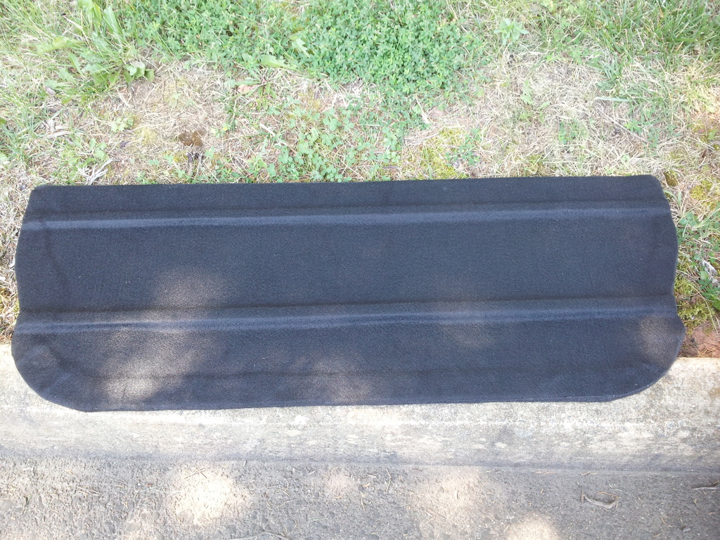

I made a DIY cargo cover and used cheap curtain rods as support. This is what I'm talking about:
Looks like this underneath. They are positioned so they sit on the "lip" of the shelf supports. It's quite strong, yet still very lightweight. This thread actually gave me the idea to try it on my own. I found the foam board did bend over time, so I added the curtain rods and haven't had a problem since:

Finished product:

Spent less than $30 versus buying the Honda spec one

Originally Posted by 2Rismo2
I made a DIY cargo cover and used cheap curtain rods as support..........
That looks awesome. Where did you guys manage to find that large piece of felt? At Michael's?
Also, what do you use to stick the felt securely onto the board? Will hot glue gun work?
Sorry, didn't see this post earlier. I bought the felt at hobby lobby, but I imagine any craft store like Michaels would have it. Even Walmart has a fabrics section. I used a spray adhesive. I put multiple coats and let it dry tacky for a few minutes. Then press it down firmly and put something heavy on it for a while. If you use hot glue, it may show the thicker lines of glue.
