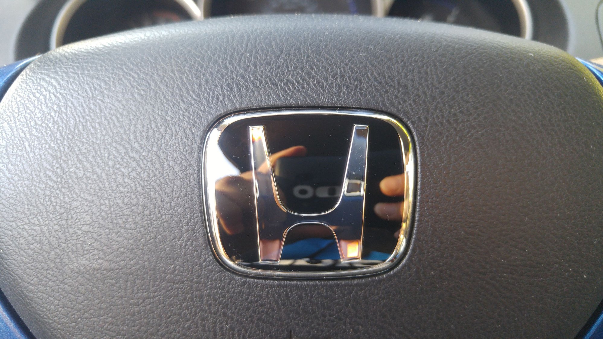

Tired of that faded emblem that has plagued almost every GD3 fit? Well, here is your chance to upgrade it!!

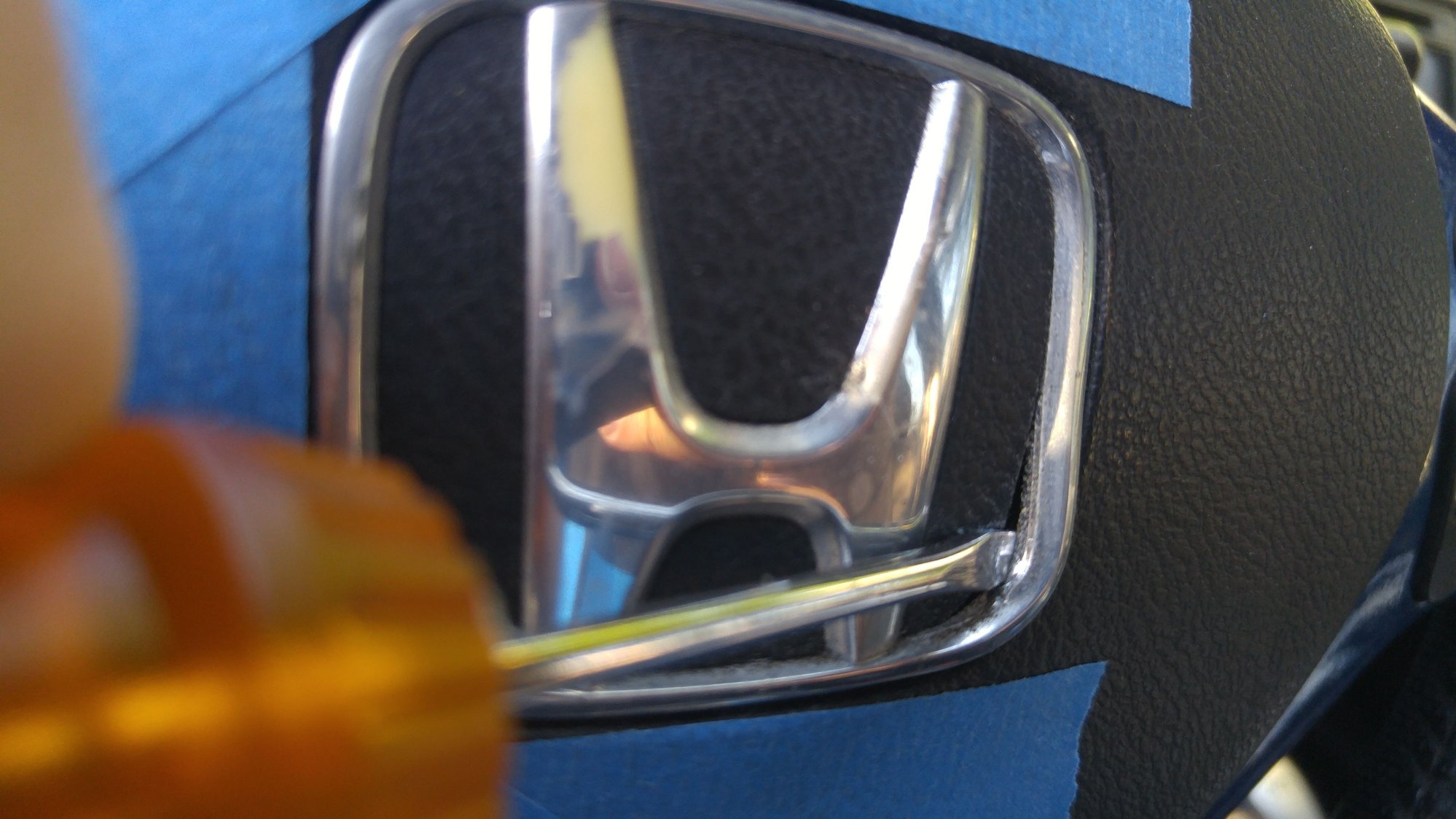

1) Take your 10mm and disconnect your negative ground battery. Turn on your headlights to drain any leftover power.
Mask off around the emblem to prevent scratches (optional)
Stick your small flathead here to lift up the edge. Lift up the INSIDE of the emblem b/c if it got damaged, it's not visible anyways.
Once you lift it up, grab your needle nose pliers and pull. You will find many rubber pins holding the emblem on. Pull them out, the outside edge ones come out easily.
The middle ones don't come out. Use a sharp utility knife and slowly cut them below the surface. It's rubber so it cuts very easily. Don't let your blade slip though!!

Done!
