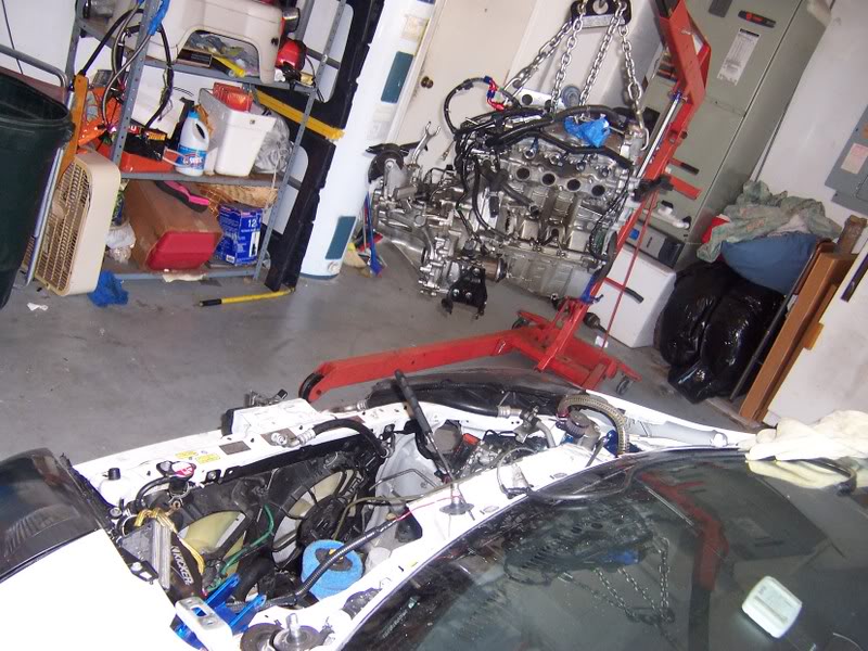

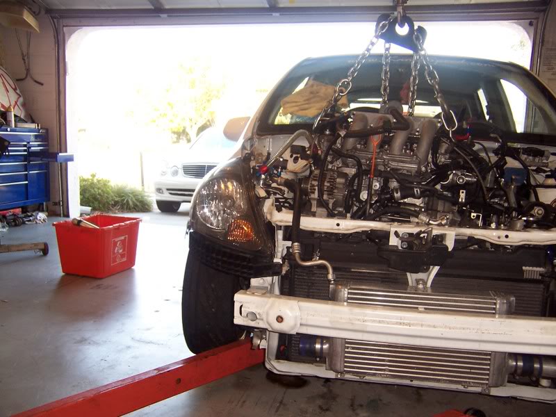

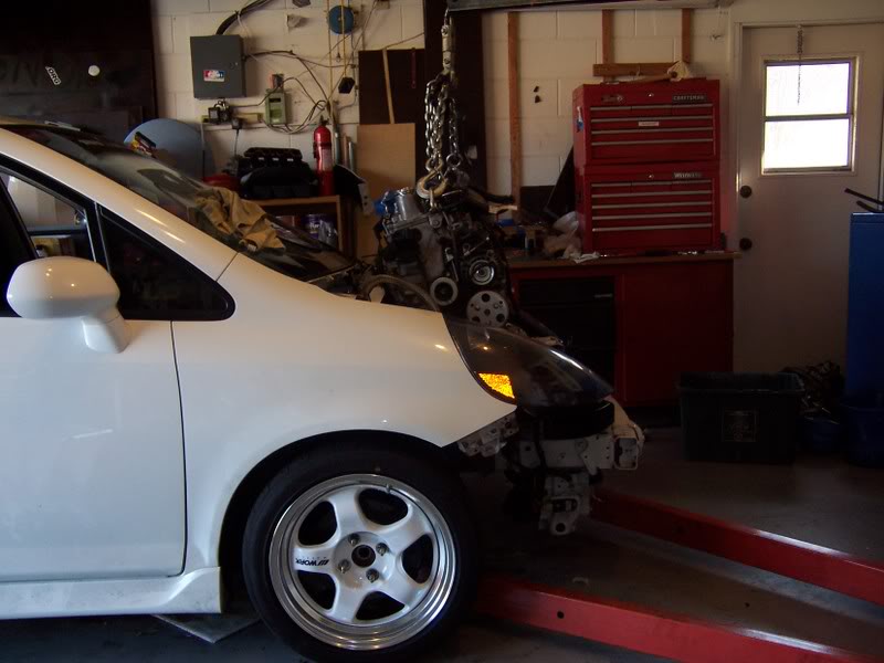

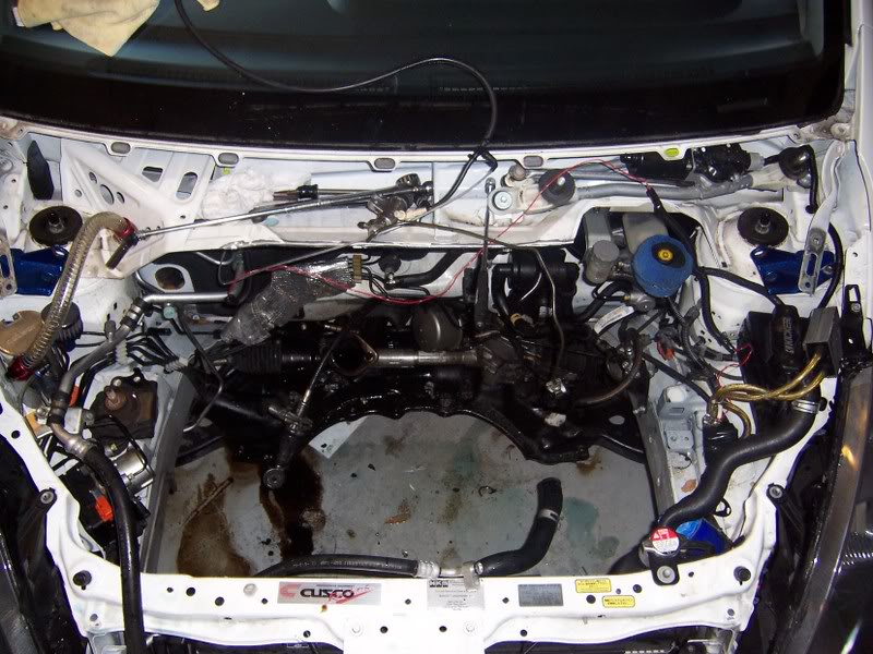

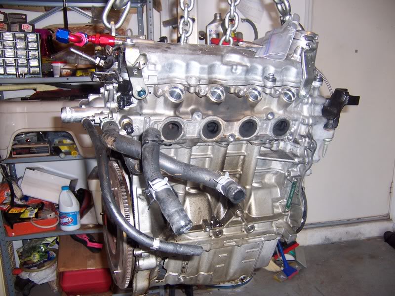

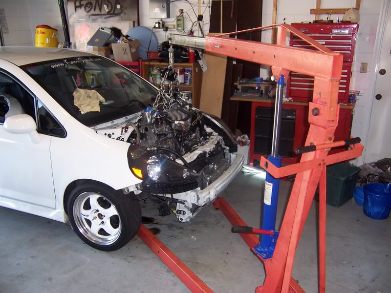

MOTOR IS OUT!!!!!!! YYAAAAA

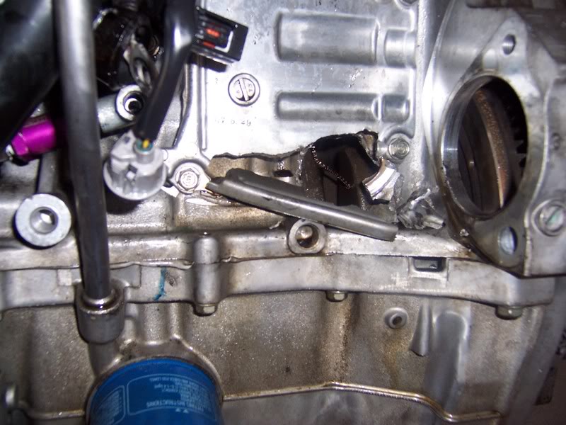

O what,,,, how did my starter get dented????
O yeaaaaa now i remember a rod came shooting out of the block at it. duhhhhh and look, i found a new hole
i just got the wiring harness of her and ill soon pull the head, stay tuned for more pics

I can see you had an exhaust leak.

Posts: 1,253
the manifold that cracked
