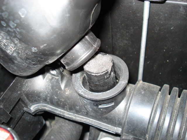

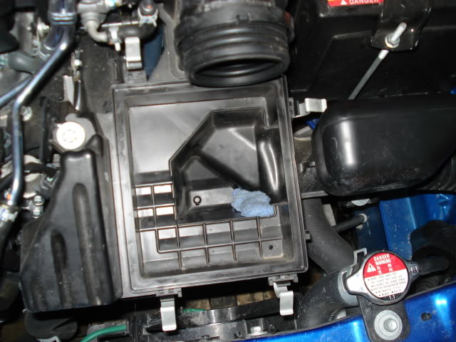

A simple resonator block for the GD3 is all it is. Yup. Although, it has to be done right. Super tightly compressed foam works well for the passage into the bulb on the snorkel, but for the main chamber under the filter, foam or tape just doesn't cut it. Foam seems to pass just enough to destroy pressure waves and the engine will tell you this when it tries to run out of breath at 6000 rpm, and tape not only moves back and forth but also just like to fall off once the temperature gets too hot. I'm wondering if this is why resonator blocks by fitfreak members never really worked and everyone complained that the engine lost all its punchiness. Also, I noticed only doing the big resonator while leaving the snorkel one intact causes a fair loss in power and a lot of noise.
Believe it or not, if you take a washcloth and fold it so many times that you think there's no way it's fitting in that slot, and you fit it in that slot, really no air can get by. Mine started as a mildly used oil rag so that may have helped in the squeeze.
Voilá, a $.15 way to get some top end power without losing much of anything over 2500 rpm (although I will say it doesn't have the stumpin torque under 2k anymore, but that's ok it never accelerated much there anyway), the highway noise goes away, is easily reversible, and if anything ever comes loose it can't get sucked into the engine because the filter is in the way. Thought maybe this could be a cheap easy mod for people who don't want a whole new intake, you know now that it works like it's hoped to.

The filter in the car
ragtag mod
up close, a 10"x10" rag stuffed into that tiny little slot. I folded 6 or 7 times and it barely went in. it isn't moving or leaking much if any at all
Plug the snorkel box too! It makes a difference. This started as a 3" cube of window air conditioner stripping

I hear ya on that one, I had an aem cai on the old civic and it was a big difference. Best mod I did. However the day we got hit with 8" of rain in an hour two years ago the week I sold that car I decided not to put one on the Fit. No more bumper filters.
The only intake I'd consider is the PRM, but since this does well enough for me, meh I'll save the $$$, and if I ever have to go to the dealer it's pull pull done in 2 minutes.
I will say I'm thoroughly convinced this setup makes more power than the SSR speaking from experience although that one sounded meaner.
