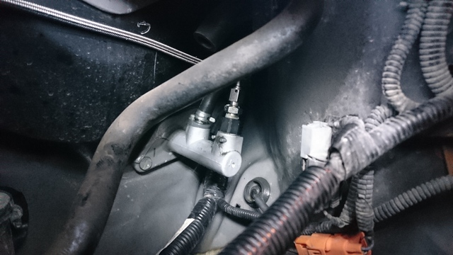

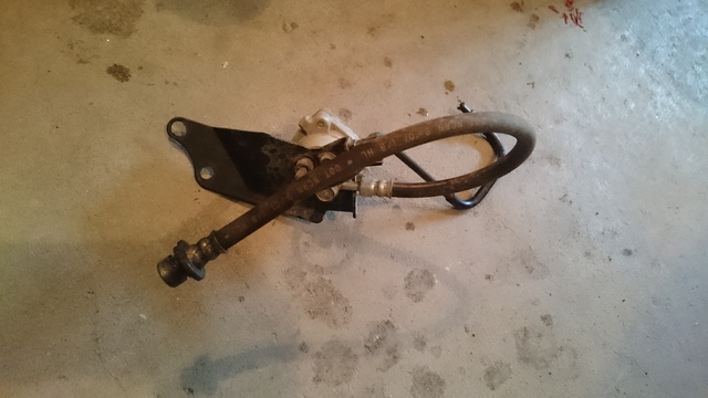

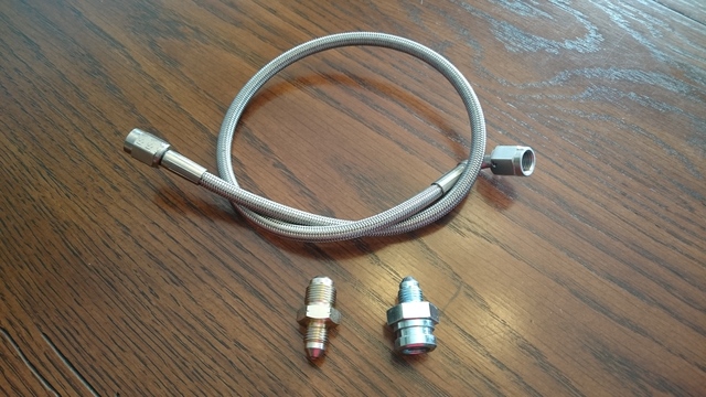

Today I also received the parts to delete my clutch delay valve. Ordered everything from ANPlumbing.com.
Parts ordered were:
989537ERL - Brake Adapter (Honda application) [$5.45]
305-03-M121P - 12mm to -3AN Male, Steel [$14.99]
63011720 - -3AN Hose, 90deg, 20" Long [$20.88]
**Prices in USD**
Links to the DIY I followed:
https://www.fitfreak.net/forums/fit-...-line-cdv.html
https://www.fitfreak.net/forums/fit-...-hardline.html

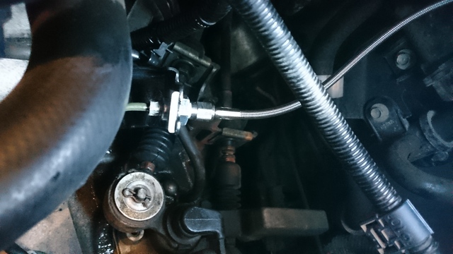

Finished the CDV Delete DIY today and I must say that I like how the clutch pedal is now, a little bit of a cable clutch feeling.
To anyone planning to tackle this task: USE A FLARE NUT WRENCH TO REMOVE THE FITTINGS! Well, at least on the one that connects the hard line to the rubber line. I stripped mine but was able to crack it open with a vise grip, already ordered a replacement part but with a 2-month wait.
I also ordered the 20" SS line, IMO the 18" should work perfectly. 20" has a lot of slack though, if you want that.

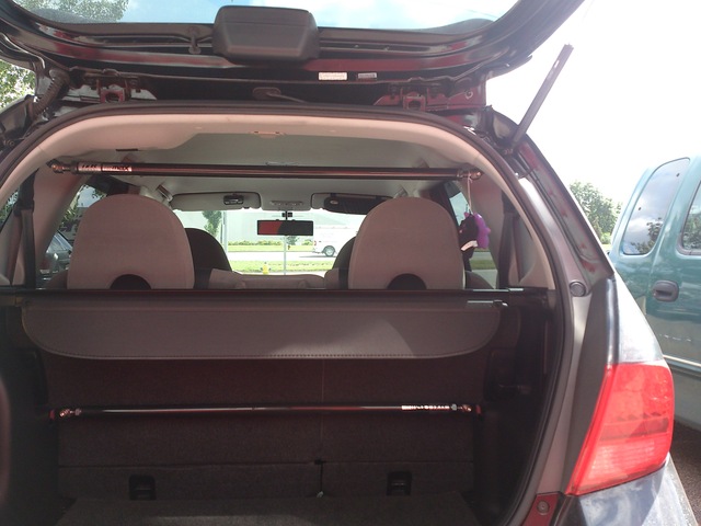

T1R rear strut tower bar and c-pillar bar:

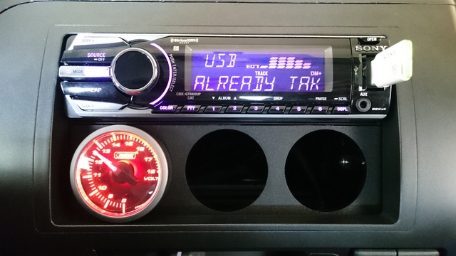

Installed my Prosport volt gauge:

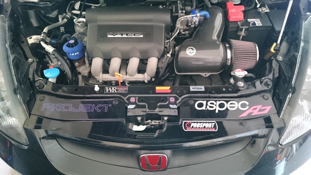

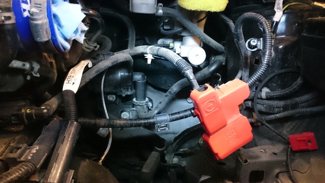

Engine bay clean-up:
