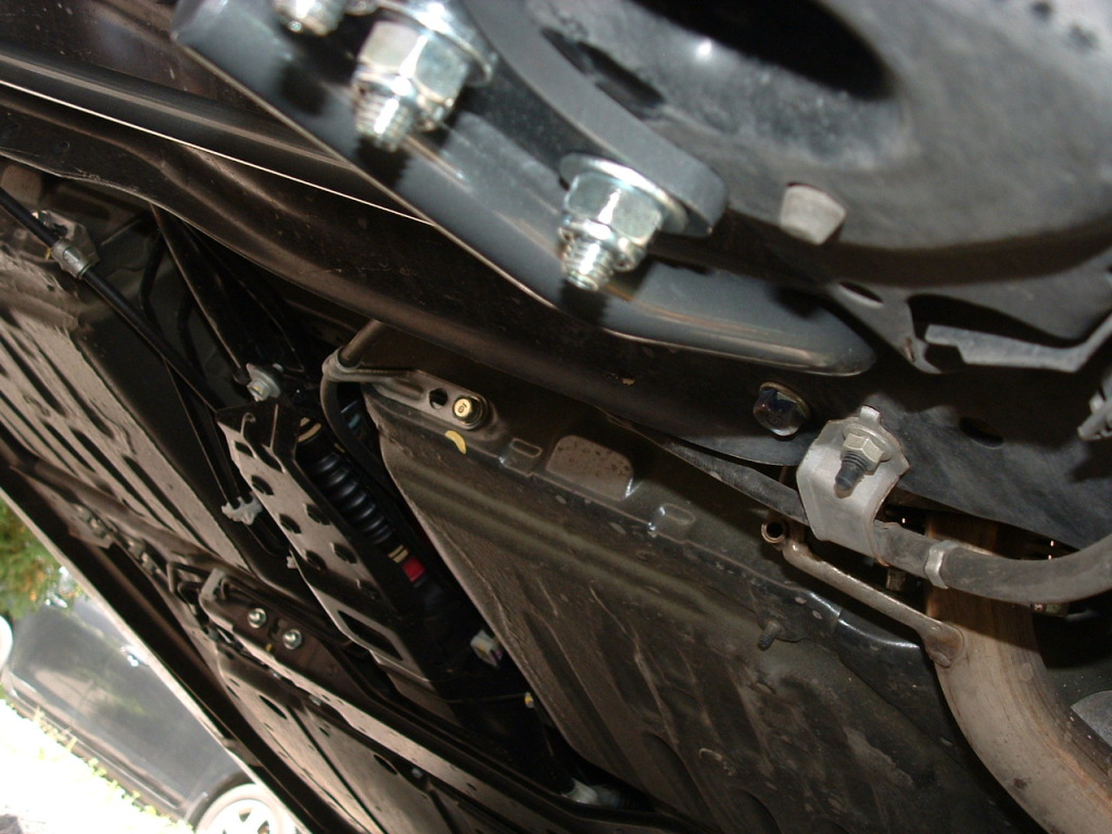

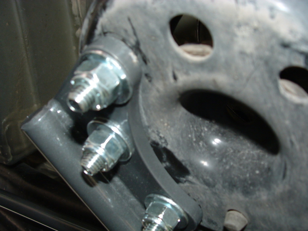

Progress rear anti sway bar install
Progress Anti Sway Bar Install
Today I got my sway bar via the UPS guy.
I had to go to Canadian Tire and pick-up a few things first.
My fit did not come with a jack - thanks Honda - It doesn't have a spare in the trunk just a puncture repair kit.
I also purchased the Jack Stands and the anti-roll chummies. The ones to prevent the car from rolling forwards.
It was a straight up install no big surprises except the instruction provided by Progress say that I had to remove the rear springs but that is not true. I just used a flat head screw stick to move the rubber seal out of the way to drop in the bolts. It only affected one bolt.
I used the DIY Progress Rear Anti Sway Bar provided on FitFreak by Mole177
Here's the link:
https://www.fitfreak.net/forums/2nd-...r-install.html
Onto the pics!

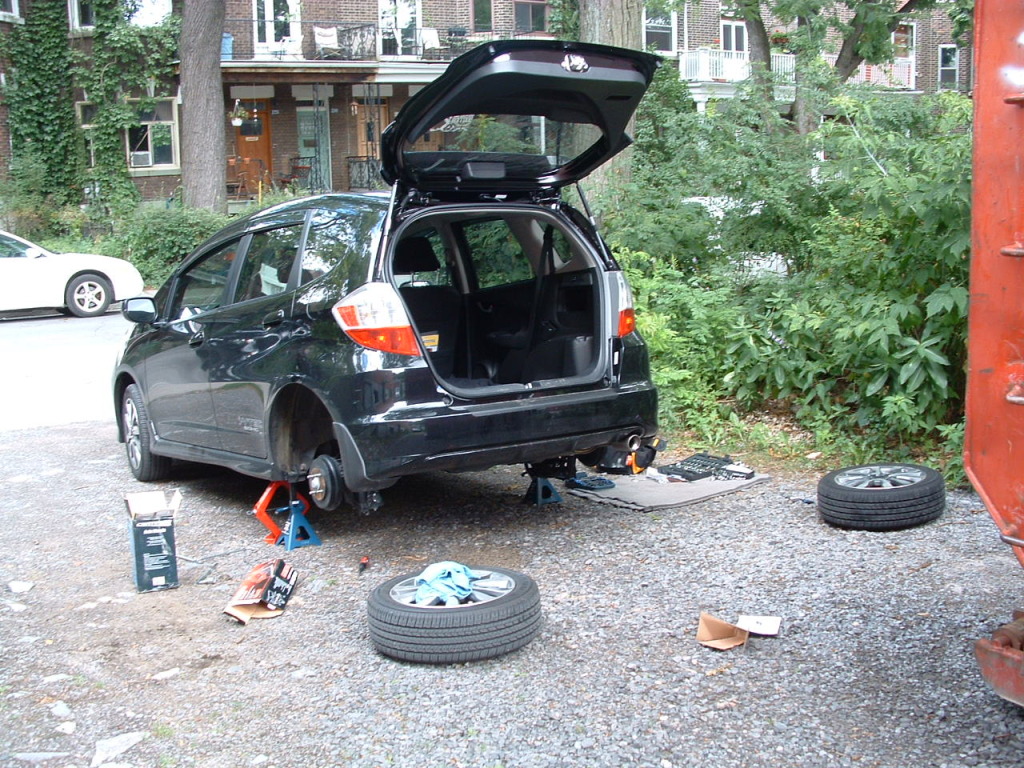

No comments about my work site please.....Living in the city you do what you can with what you have!

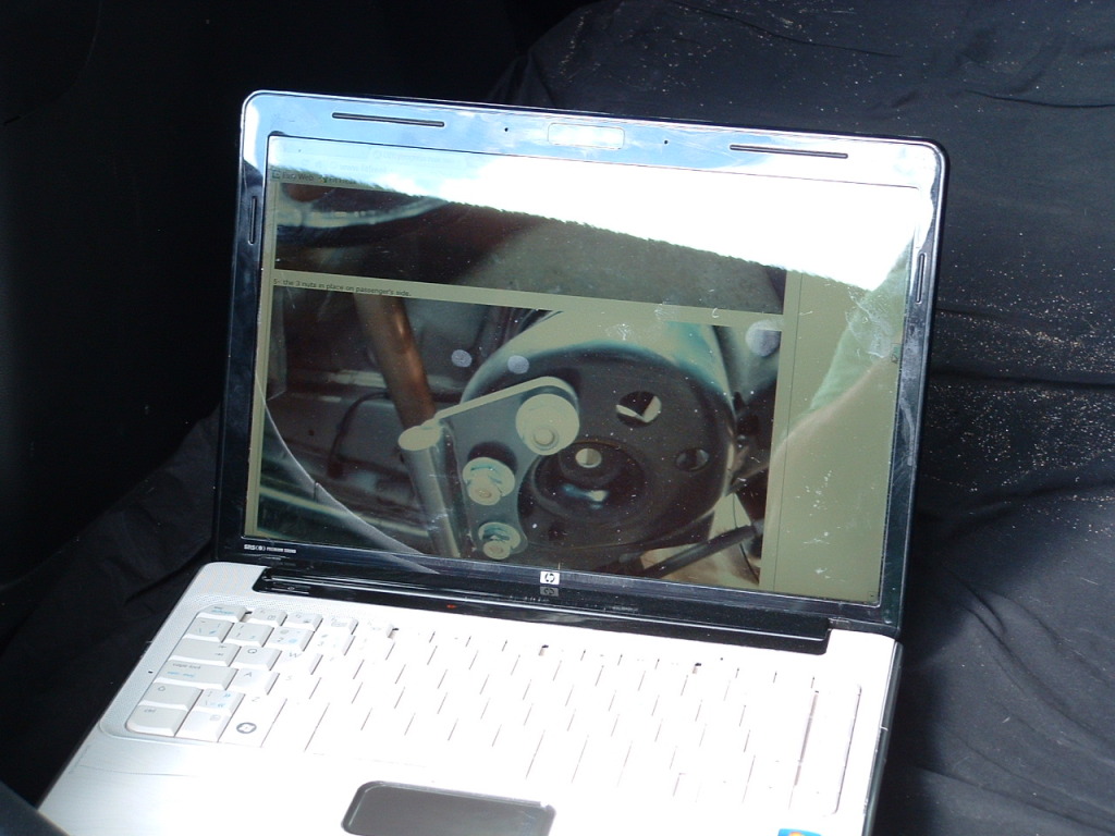

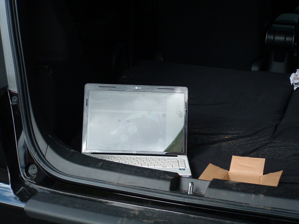

Laptop in the trunk with the DIY....Helped a lot!

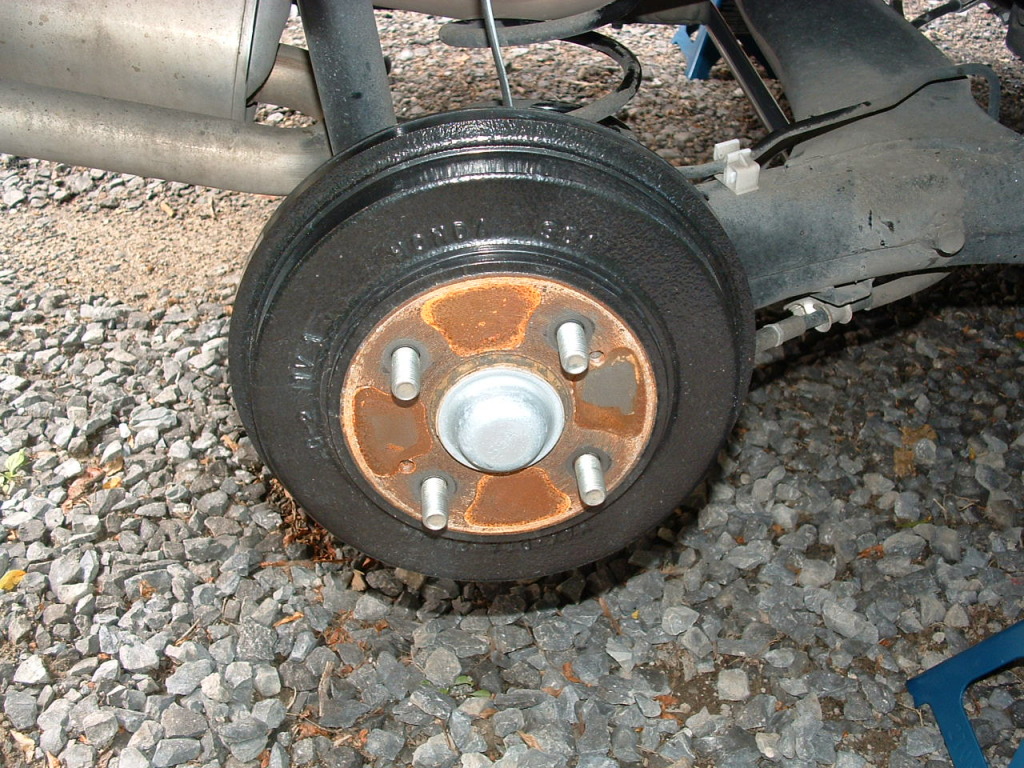

Triskelion : what can I put between the wheel and the mounting surface to prevent this rust! it's driving me banana's.

Old Aug 6, 2012 | 05:24 PM
Triskelion's Avatar
Joined: Feb 2012
Posts: 769
Here's the link:
Onto the pics!
FitFreak obligatory shipping container box picture with label...
Good work on the sway bar. Use a wire brush to remove rust, then either high-zinc content paint or Amsoil anti-corrosion spray (that will have to be redone periodically). Tape the studs to keep paint or anti-corrosion spray off the threads.

Thanks I will try that!

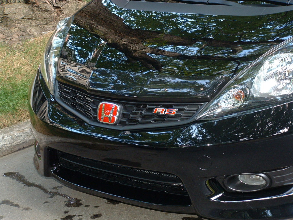

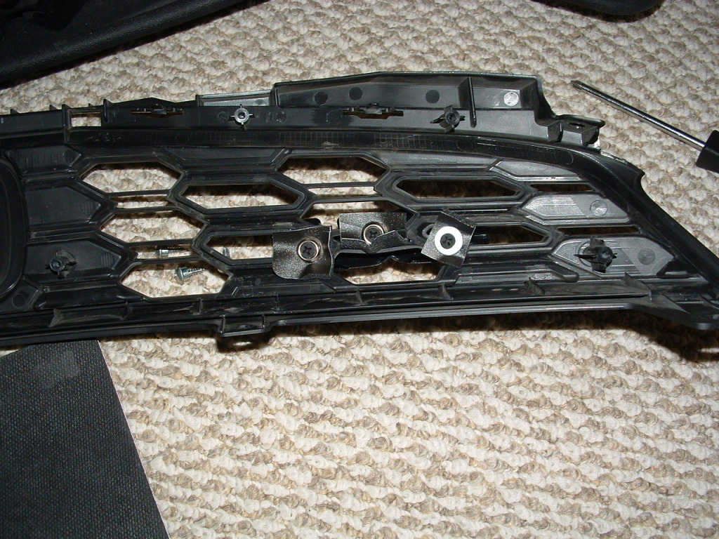

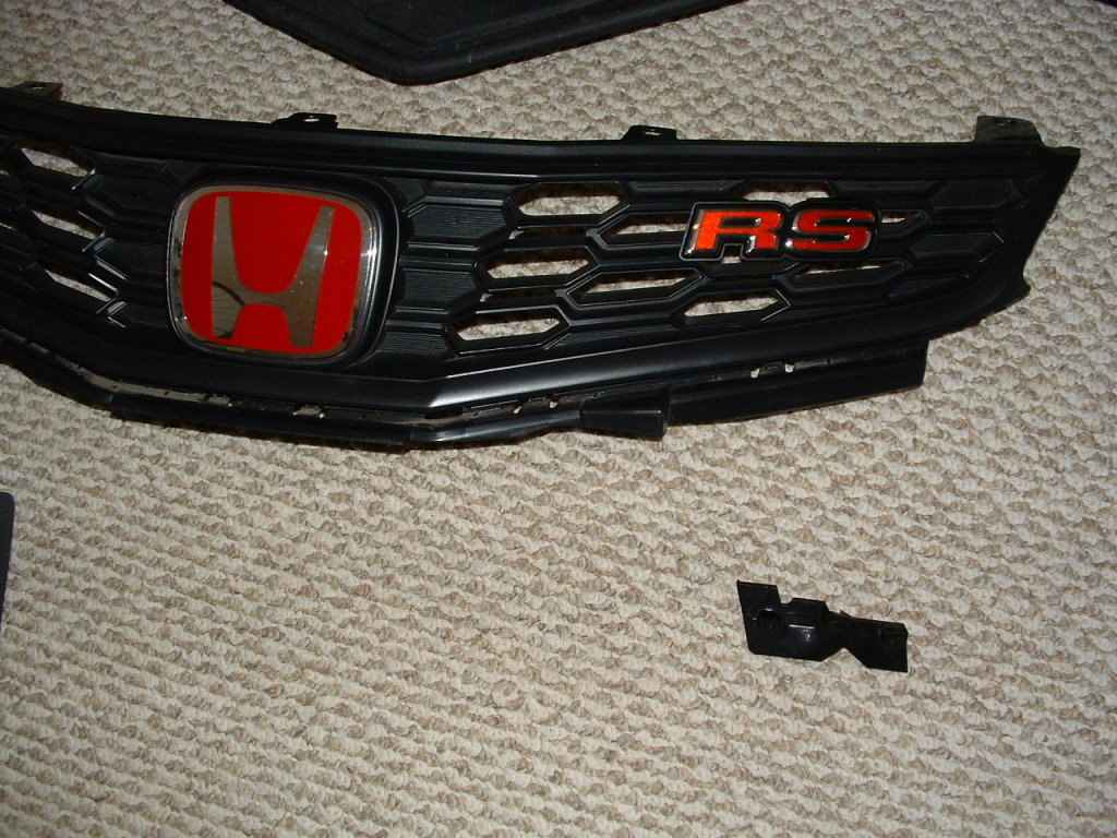

RS emblem install on a 2012 Sport grill
I ordered the front RS emblem full knowing it would not fit properly on a 2012 Sport Grill.
The backing itself cannot be used because of the difference in the honeycombed shape of the grill. It simply will not fit back there without some serious hacking.
As well I recommend removing the grill for the install. On a 2012 Sport there is a scoop that directs air from the grill to the back of the engine bay where the air intake is. You will need to remove the air scoop (four screws) to install the emblem.
My solution was to use squares of an old mouse pad I had laying around with a washer. I could have fabricated a new backing plate but the screw holes on the emblem itself are at a 45 degree angle. The mouse pad material should hold up for a good long while and it wont damage the grill. A bonus is that they do not block the air flow to the air scoop.
I basically made some big rubber washers out of mouse pad material.
And here is what it looks like installed.
I can't believe how these little additions make my Fit so unique in Montreal. Down in California I am sure you must have to be very creative to stand out....In Asia? Forget it....my little Fit wouldn't stand a chance...Those Malaysian Fits are so damned awesome...

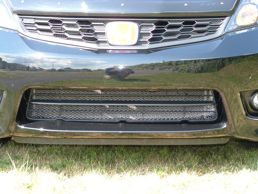

DIY Lower grill mesh protector
I used the DIY on the site to install a mesh to protect the AC condenser.
They are a ton of money to replace (the condenser that is. Somewhere around $700 plus) and it only cost me 10$ at the Home Depot to protect it for life!
And you know what's neat? it's held on by plastic tie-ties....you can't even tell.
A no brainer. I have had it on for a good 6 weeks now and only the smaller bugs get through. No rocks or other debris have made it past.
