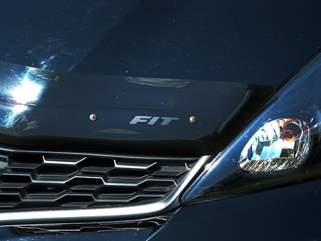

OEM bug deflector

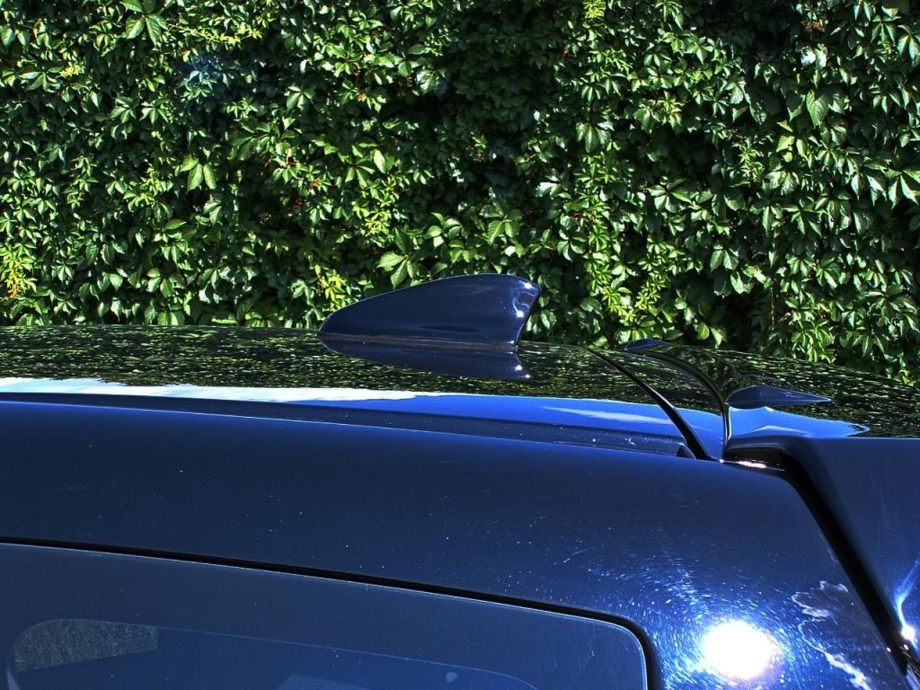

VG Shark Fin antenna

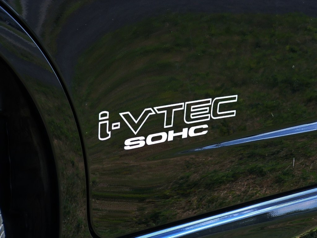

IVTEC SOHC decal

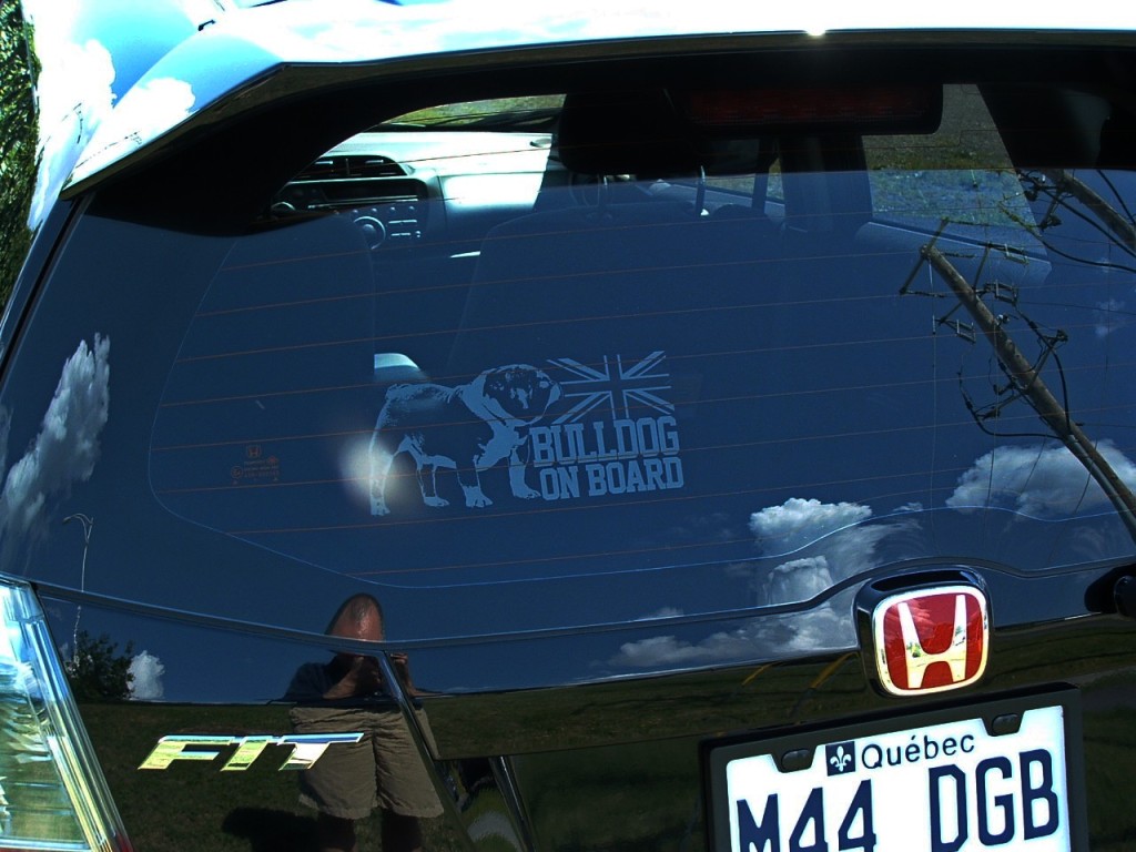

British Bulldog on board decal (the reason we bought the Fit in the first place)

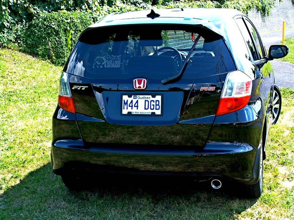

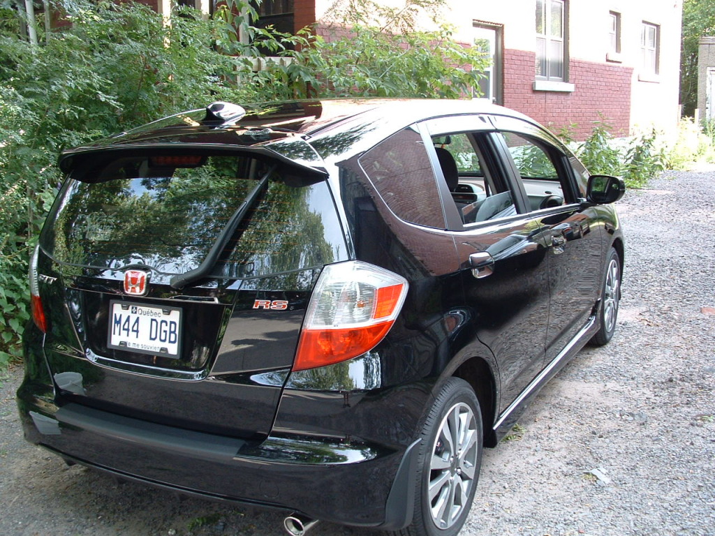

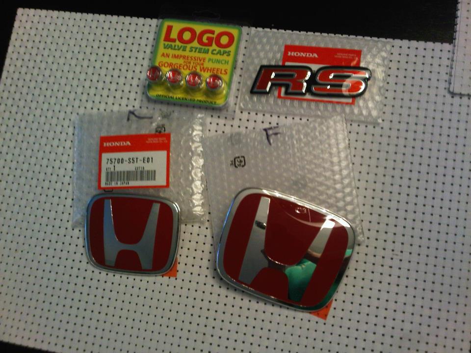

JDM Red H emblem – Front
JDM Red H emblem - Rear

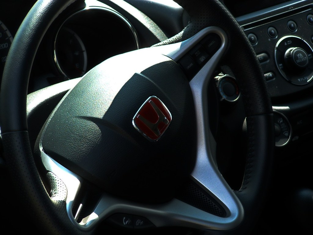

JDM Red H emblem - Steering wheel (death by Ninja star special)
JDM Red H emblem – Key fob
RS emblem - rear
RS emblem - front

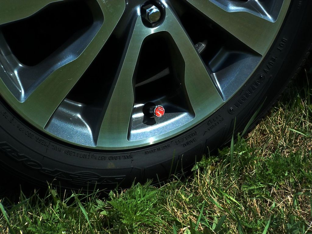

Red H tire valve covers
Red H oil cap.

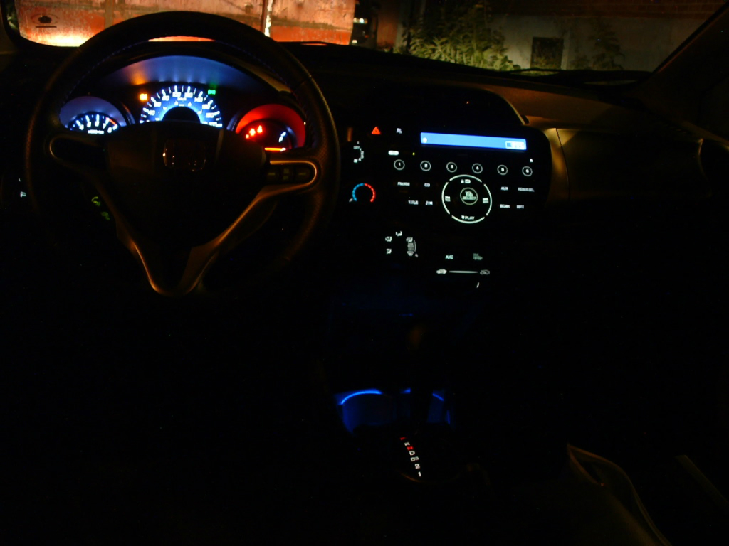

Dome light - blue LED
Cargo light – blue LED
Map lights – bright white LED

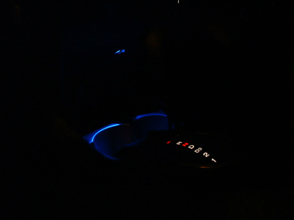

Cup holder light – blue LED

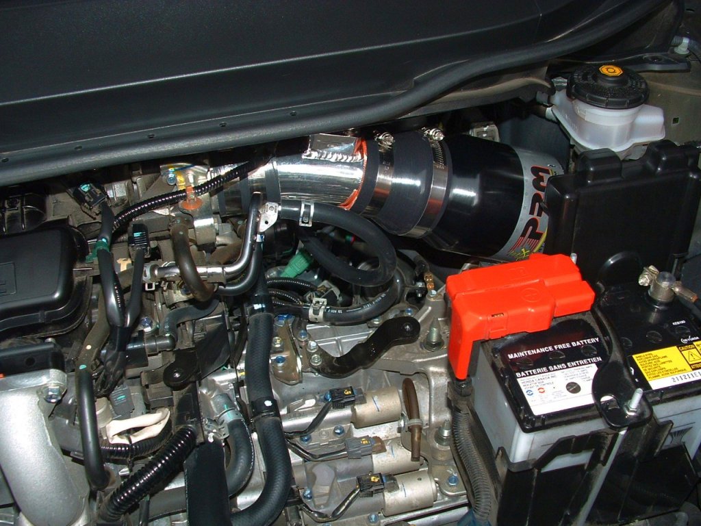

PRM cold air intake – OEM intake sitting in closet

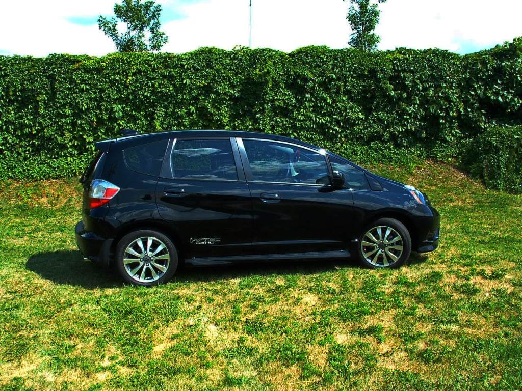

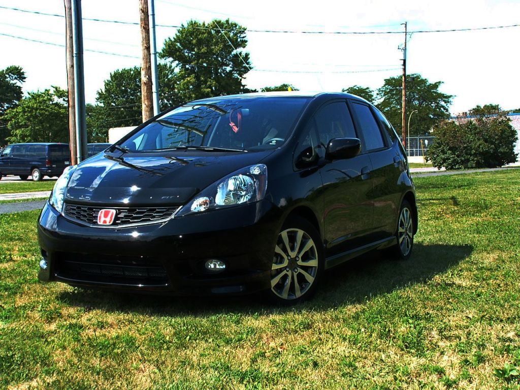

Car looks good, Dwayne!
Think you fluffed that mod list a bit though.
Some Swifts, ETC, Brembos, Hawk pads, a set of summer tires/wheels, good fuel and cold plugs can make for a fun commuter and auto-x car.
FWIW, a good set of 195s will run circles around a mediocre 205. Contact patch is only part of the game.
Make yourself a plastic/phenolic airbox and pull from the cowl area otherwise the PRM is only sucking in hot air.

PRM intake: on my 2012 there is a duct that transfers air from the front of the car to the immediate area where the air is sucked in. Do you think something like a housing on a K&N CAI would really make an impact? Building a housing would be the easy part. trying to find a mounting point would be the hard part for me. I will do my research because I am sure it has already been done. I will report back
Quick question: Do I remove the PRM intake and re-install the stock box for servicing at Honda? Warranty issues. Would they flag my car in their computer? (this question is preoccupying my brain bucket. Alot)

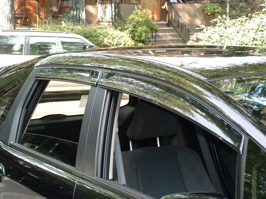

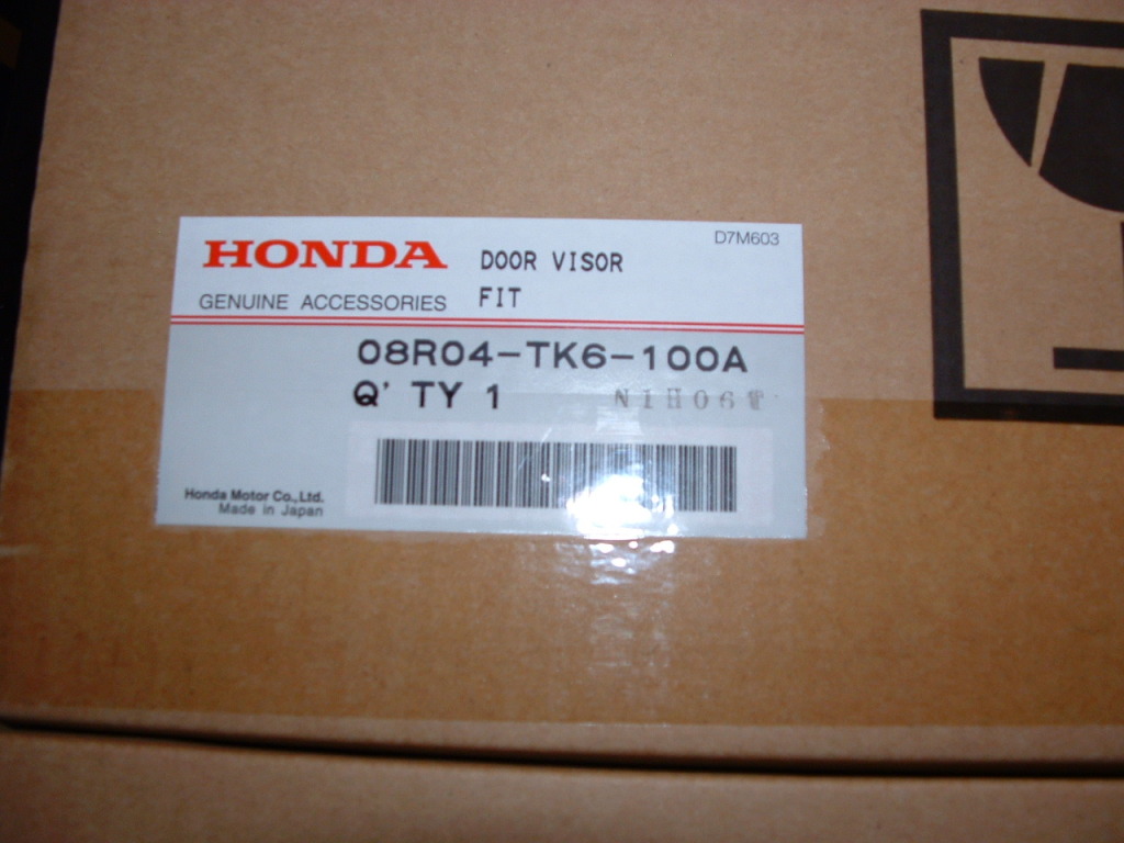

Door Visors
came in this afternoon!!!! Woop Woop!
I went with the OEM Honda visors simply because they came with clips. The eBay ones were a bit cheaper but only had the double sided tape.
It took me a lot longer than I thought to install these. About two hours. Learning curve.
If I had to do it again it would prob take me 30 mins max.
I had the YouTube Video and the PDF instructions on my iPad out there with me.
The guy in the Video actually puts the EPT sealer in the wrong place. The actual Honda instruction are much better. Both links below.
I have no idea what this EPT seal does. Some sort of foam insert that goes in the window sill around half way up the rear doors only!
Mystery wrapped up in an enigma! But if I had to venture a guess it's to keep the back windows from vibrating...Wonder if the cheap knock offs come with this stuff. Or heck maybe they are designed better and don't even need them? Who knows...time for supper.
Video:
Episode #227 - 2nd Generation Honda Fit Door Visor Installation - YouTube
PDF:
http://www.collegehillshonda.com/ins...doorvisors.pdf
I have installed visors three times, on two Fits. The last time was a replacement of visors that were installed by a body shop after door skin repairs, and they did it wrong- the visors fell off a few months later.
The secret of easy installation is: fasten all clips and pins to the visors before you start the installation. Face the clips away from the window edges, position carefully and attach with the double face tape. Then use needle nose pliers to rotate the clips upward to latch onto the inner edges of the widow frame.

This is the absolute last time I install anything without communicating with you first!!!

Hah! I have tried to interest other people in this technique, but nobody wanted to learn. Trying to install the pins and clips while the visor is on the window is ridiculous! I am amazed that the factory instructions tell you to do it that way.

I'll tell you with my 195/55s on the 15" wheels, I easily break traction, whereas with the the 205/50s on either 15 or 16" wheels I do not. I'm not using crap tires in either instance, maybe the Advan AD08s just have more grip than the new Dunlop Direzza ZII (not released outside of Japan yet and maybe just like to scream more than the Advans), but I think it has more to do with the loss of 12mm of contact patch.
Not sure how you drive actually, but just thought I would put that out there since you are considering going with 195s over 205s. My Fit is making a miniscule bit more power than stock so that also plays a part.
Take care of those swirl marks, you have LOTS of them. Black shows them off so easily in the sunlight and just takes away from the vehicle overall.
Old Jul 30, 2012 | 09:43 PM
Dwalbert320's Avatar
Joined: Apr 2012
Posts: 664
From: Montreal, Canada
F* me my good man....when I saw the pics I took on the computer I WAS SO EMBARRASSED to put them up...Hugh...swirl marks. OK tomorrow is the day I get rid of them. You must have noticed the heavy Photoshop fixes....So BUSTED!!!
For tires...You see what I really want is a smooth ride and confidence in all kinds of weather. I transport my prized possession in this Fit, my little family.
And you know when I look at my Fit from the rear it looks so pathetic with the 185's....
I like to have a little fun with my Fit too. I am very torn on this issue.
Thanks for taking the time to comment. It is appreciated.

Ahh that'll mess it up. These aren't exactly the same, but you should look into Rotiform BLQ, they have similar styling and you can get them in 17" and 4x100.
You don't need to keep OEM diameter/width, a 17x7 would be perfect on a GE.
Hey! thanks for taking the time

If I had to do it again it would prob take 3 hrs
I survived 3 clicks on a search botton and installed 3 sets of these. 30 min sounds a bit optimistic. I believe it though. You've surprised me already.
