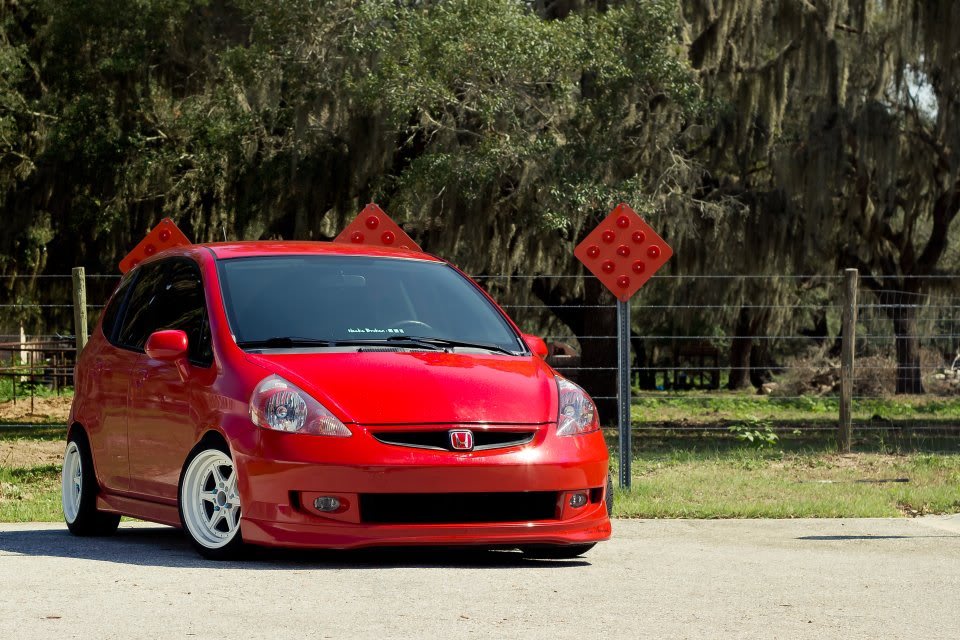

So today I went through my suspension with a help from a few friends. The guys that installed them basically did it ass backwards and I almost blew my shocks this defiantly was a learning experience I raised the rear and front until I can get new tires this weekend.
so this is what my car looks like now

how did you almost blow the shocks?
Old Jun 4, 2012 | 12:30 AM
DreaMv's Avatar
Posts: 1,632
From: California, 562
+15 offset?
what do you mean they installed them ass backwards? did the lower the fronts using the preload collars?
