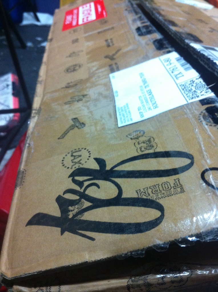

Got a package today at work

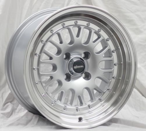

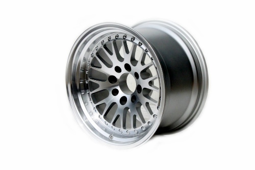

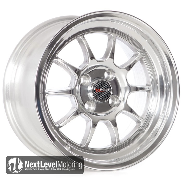

Now the second part to this post is you guys giving me some input on wheels...
Here is what I'm looking at (already narrowed down the list to these)
Chikara RS8 (15x8 +25)

VarrsToen V3 (15x8 +25)

Drag DR16 (15x8.25 +25)

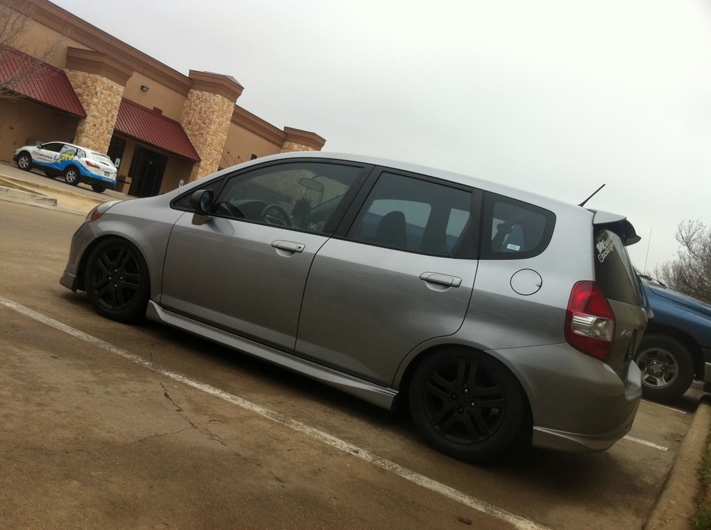

Hey guys, its been awhile..
Don't have a lot of time, but here is a picture of the stance. Taken at DFW Alliance in Texas. I was the only fit out there! Where are the rest of you!?
Finally rolling on VarrsToen V3's 15x8 +25 | 195/50/15
Front is maxed out and front locking collar removed. Fenders are rolled and pulled (I pulled them via phonebook method, just used a catalog instead, as well as my hands) Removed my fender liners and cut bumper tabs. Rubs when turning kinda sharp.. :/ U-Turns are avoided if possible
Rear is raised in the picture due to the huge rubbing problem. I ate up some tire back there one night after rolling my fenders. Raised it as soon as I got home. Tomorrow, I'm having the help of a friend and we're going to do the ol' washer trick back there. Hoping that will give me the camber I need to clear. And it will look pretty when it can finally sit down
I will be ordering 195/45/15's all around. Thinking this is going to solve the rubbing up front a lot, if not all the way, a good bit. May have to camber more up there.
