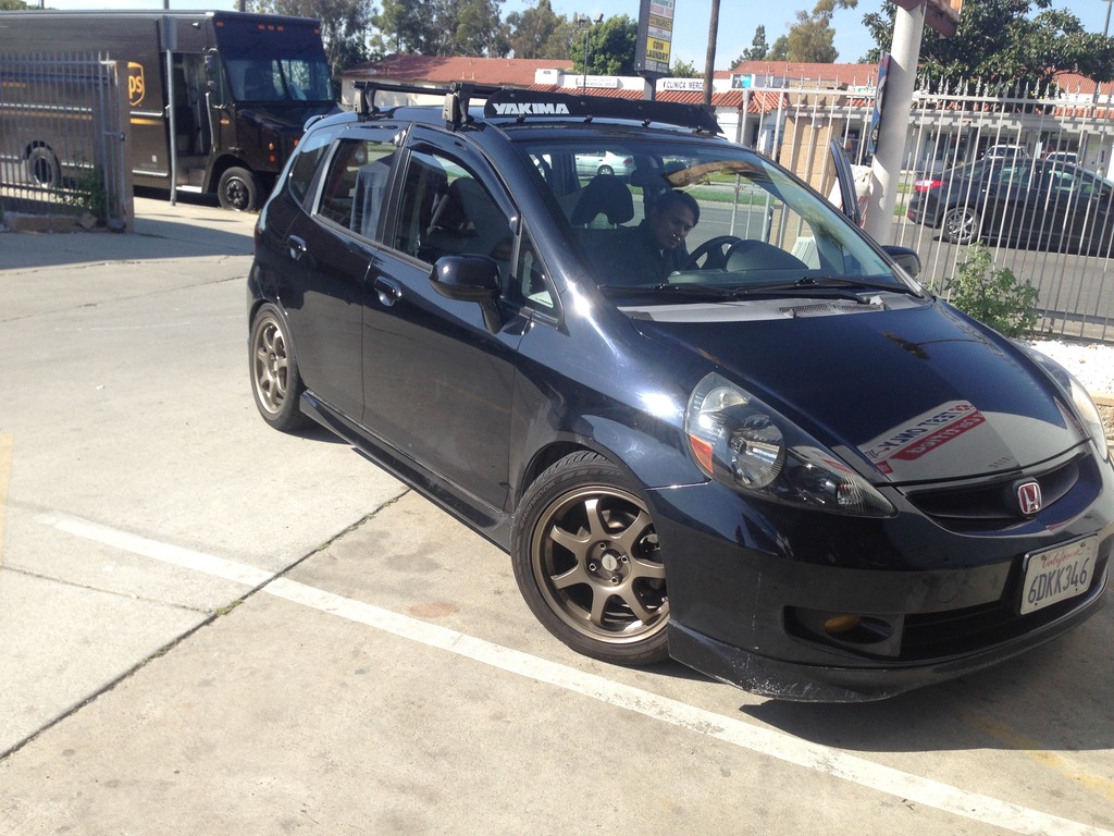

At the moment I have Skunk 2 springs and some knock off struts (I haven't been able to see a brand name on them). But in other words the ride quality is pretty bad. Rubs with 4 people non stop, Big dips with only myself in it, hits my lip, and gets scratched up. Just all around bad and its time to change.
Lip is worse now, Here it is 1 year ago. Wheels are 16x7

Okay so I've been searching for the most comfortable strut/shock setup.
My plan was to get KYB Struts and Swift Springs. ~$600 if I install which is about my budget. I do not want coilovers since its more of a daily then anything.
I was also thinking about just going straight to stock but stock springs are even more expensive then something aftermarket such as Swift Springs. I've also heard stock is a bit too bouncy.
I like how Swift Springs are not too much of a drop and they seem like they ride pretty decent for lowering springs (from members' experiences). There is a pretty good thread on this site that everyone chimed into.
How I drive:
I do not canyon my car, maybe sharp turns here and there, and on ramps are pretty fun, but the Skunk 2's are hurting my car more then anything. I drive at least 40 miles a day and sometimes 100 miles and I am always driving the speed limit because you can't do too much with 100~ horsepower in California traffic.
What I want:
Comfortable ride, maybe a small drop to make my wheels look somewhat decent. Zero to no rubbing. Body roll controlled.
Tell me your opinions. Wish I had other Honda Fit's I can try but I don't know anyone with another GD3... Thank you.
