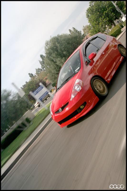

it will only look dumb if you dont have a low enough drop to compensate for the extra little gap you will have.
like if your running eibach sportlines you should be alright
heres a picture of 205/50/r15 on some ls meshies, with tein s.techs.
i thought it looks sorta funny because it added an extra finger gap all around. people said it looked fine, but to me it made the wheels look smaller.Name:  scp26.jpg

WELL the wheel is a 40 offset and i dont wanna rub. esp if i get the prokit. but ya i dont want it to look dumb if i do the prokit and have the tires look to small. but i think it will rub with 195-55's

no way.
because i didnt rubb with a 38 offset.
and 55 series will not rubb either.

What is the offset of your ordered 15's ? If its less than 45 mm don't count on lowering without rubbing with 205/50x15. You might get by with 195/55x15's but it will be close.

With the 40 offset and lowering; if you lower more than 1.5" go with the shorter tire (22.67" diameter) but if you lower less than 1.5" you can go with the regular diameter 195/55x15's (23.44") with good assurance. The 195/50x15 will only have 3% speedo and od error.
