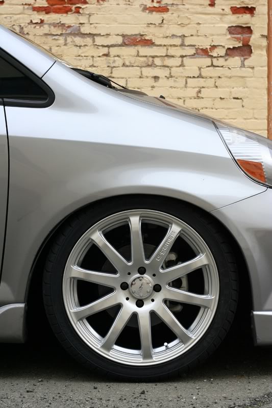

im rocking 17x7's on my fit. +41 offset. they rub a little in the front. only on bumps and some turns.
then again, i am tucking tire haha
