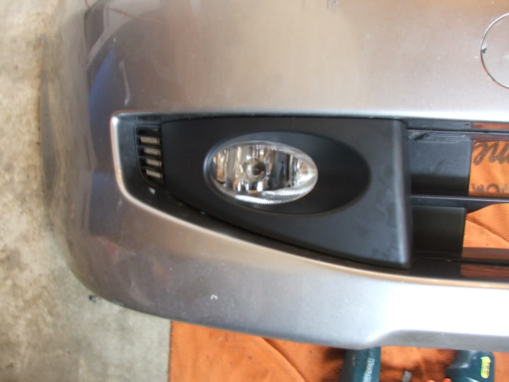

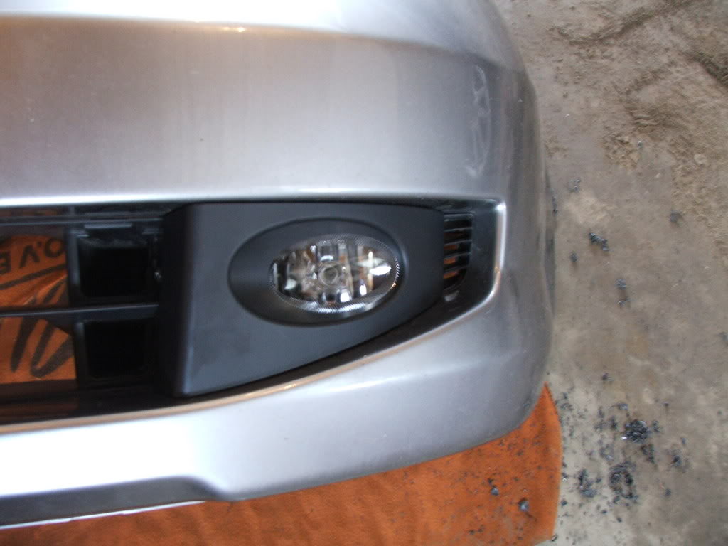

After recently scooping up some OE fogs for a great price, I figured I would take some pictures of the install as I went along. Overall it took me about 2 hours. I took my time and didn't encounter any real trouble.
First things first. Remove the front bumper. This is pretty straightforward as there are 4 clips right above the grille to remove and 4 screws and about 5 clips on the underside of the bumper to remove. After that the bumper just pulls off.

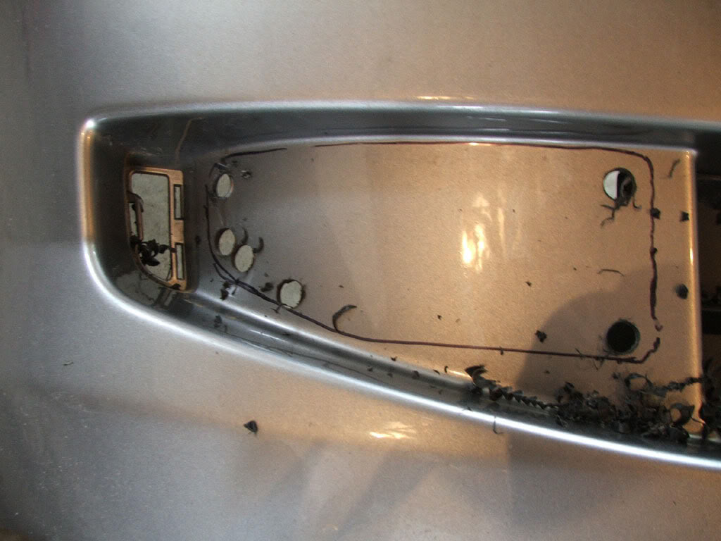

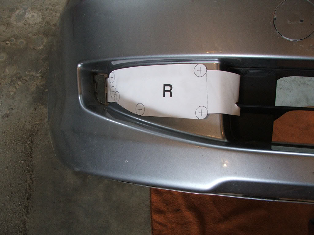

The fog light kit should include the templates you'll need to use for cutting the bumper. As you'll see, there is some drilling and cutting involved here to get them to fit.

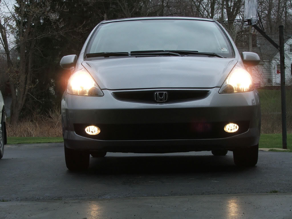

I'm very happy with them and the way they look. I will probably be covering them with yellow lamin-x film here in the next week or so to distinguish their light pattern and protect them from rocks and road debris.

Thanks! And now that nightfall has come I checked the light output. I love the nice wide beam these things shoot. And I'm lucky enough that I don't even have to adjust them. They are aimed good.
