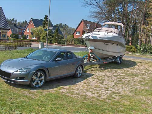

Not having a ton of CVT experience - I would say you can tow up to the limit. I've towed over the limit on a sports car - RX-8 with a manual and RWD (no diff cooler).
Dana towing a boat

Honda recommends not towing at all with the Fit. So there is no stated or recommended "tow limit".
