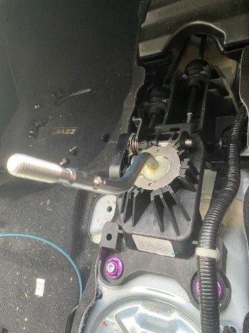

I got these shifter bushing. On the package it says fit GK5 solid shifter bushing. But I don't see you ladies trying these on ur gk5's.

Was thinking on getting them, since I have the shifter cable ones and the BuddyClub short shifter..... And had to reuse the oem ones and they were a bit TIGHT!!!!...

You went the expensive route. I am barato!! It's in!

I like them. They do improve your shifting. I used to have problem with a hesitant 3rd gear that seems to have improved. Overall it's good for the money. Onto the next upgrade.

IF you decide to get them. The install advice from me is to put rags between the carpet on the side. To prevent it falling in there.Stops you having to take the seat off and lift the carpet to get the darn thing lol.
