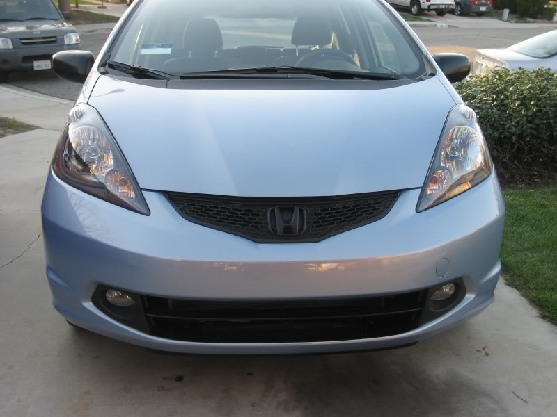

i also did my emblems.
Old Mar 30, 2009 | 06:22 PM
dela's Avatar
Posts: 2,295
From: 818/805
i used black satin...
