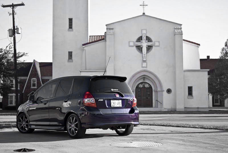

If you guys are having problems with radio reception, you should look into an RC style antenna. I got mine from my friend's VW.
