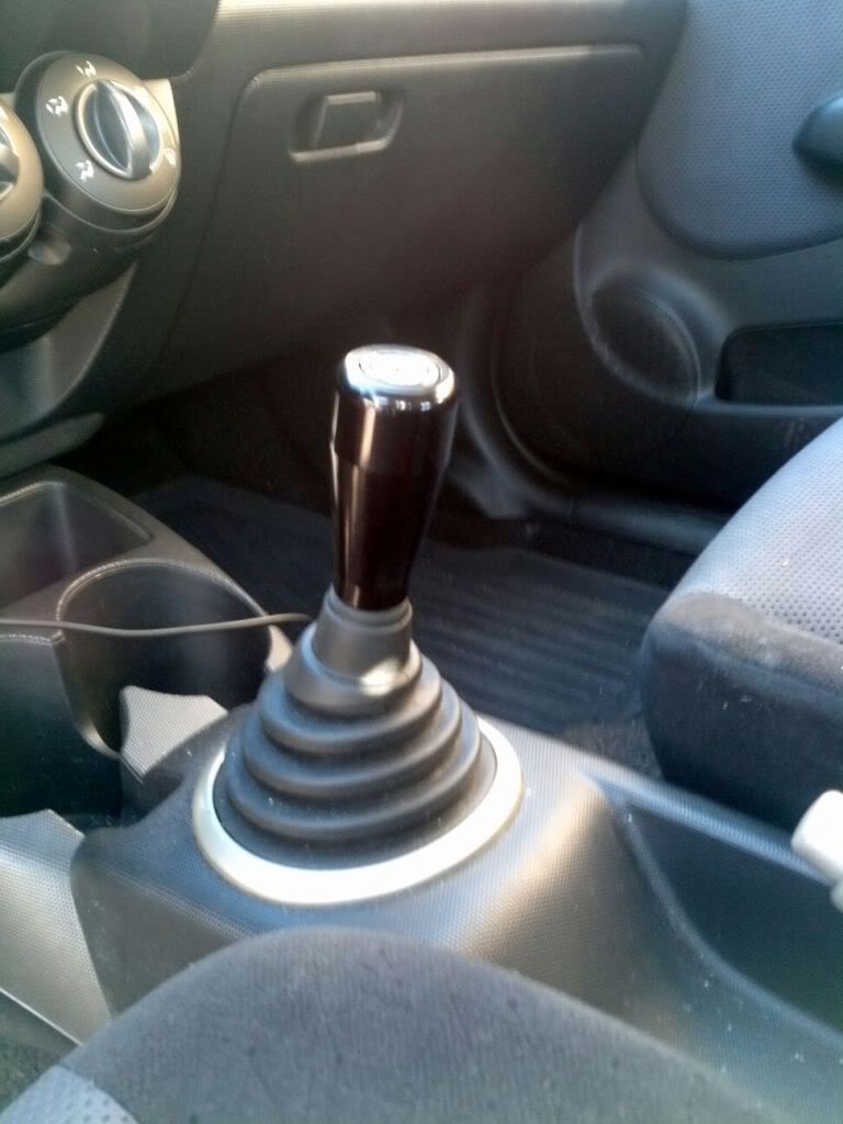

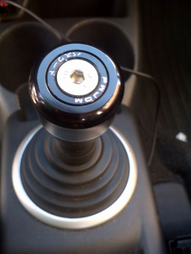

Just installed the Revo SS & my new shift knob. Its a nice difference from stock height & throw wise. The quality seems legit. I would def recommend this to anyone. I plan to try the H-Fit adapted next month. Here are some pics so far:

Installed the revo this morning; a definite upgrade. Highly recommend.
