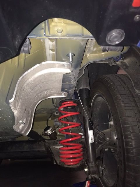

Just snapped pics of my EX-L muffler. My hanger is angled the same as evilchargerfan's. So that means it must be a Sport specific thing? Anyone want to double check me on that? Looks like non-sport has one hanger pointing towards rear of vehicle and one pointing towards pass side. Sport has one pointing towards drivers side and one towards pass side.

I just checked my 2018 EX and it also has two hangers, one on either side of the muffler, oriented front-rear. Exactly like helios's photo.

interesting .... so the sport models have a side-to-side orientation .... whereas the rest of us, have it front-to-rear
can anymore 2018+ people chime in?

And exactly like my 2019 Sport. The hanger brackets (attached to the chassis) go fore and aft, and the exhaust brackets go side to side. Couldn't we just use different rubber hangers?
I believe like the gigantic front H emblems, 2018-2019 Fits have a different exhaust hanger orientation. BTW I am now 0 for 3 on the HKS exhaust. It seems everyone is currently out of stock...

Resolution, Ben ended up removing the bisimoto hangers and had a shop custom weld on 2 new hangers (facing sideways) to mount to the oem hangers

this guy was able to simply bend 1 oem hanger .... and called it a day

yeah driver side hanger. just had to bend it towards the muffler and i used rubber fuel hose to wrap around hangers and used a hose clamp.
So the garage removed the 1 Bisimoto hanger and replaced it with 2?
With everyone being out of stock on the HKS, have had more time to mull over my exhaust decision. I have really been talking myself into one of these Bisimoto's... Looks like a quality piece of gear, it is definitely unique and unusual; I haven't heard it in person but every video I have heard it in, it sounds great, and it is about as far from the big coffee can exhausts as you can get.
However, not sure I am in love with either of the solutions used so far. I sent Bisimoto an email yesterday morning asking about their ideas/plans/whatever for 2018+ Fits. They have not replied as of yet.
I am thinking that a little bending of the Bisimoto bracket combined with an aftermarket rubber hangers (like this one?) could do the trick.

I passed along our knowledge of these 2018+ Sport's to Ariana over at Bisimoto as of yesterday, and she said she passed along the into over to Bisi himself. Time will tell, if they will come up with a solution.
I'm in agreement that bending + that aftermarket hanger will get you where you need to be. As for what Ben did with that muffler shop, you may want to send him a PM for clarification, as I simply relayed his messages and helped host his pics

I passed along our knowledge of these 2018+ Sport's to Ariana over at Bisimoto...
Funny you mention Ariana; I got an email response from her this afternoon.
I asked: "2018+ Fits have a different exhaust hanger configuration than the 2015 thru 2017 models (2019 pic attached). I assume an aftermarket hanger would address this difference. Have you guys verified this fit issue on a 2018+ Fit? And do you sell a suitable rubber hanger?
Ari's response: "We have not had an experience with the 2019 Honda Fit."
I was underwhelmed by this response. Nonetheless, I have decided the Bisimoto is the exhaust I want and I went ahead and ordered one anyway.

I need to point out that there was more to my resolution. The exhaust shop guy said that the Bisimoto flange did not mate up to the stock flange so he sawed off the Bisimoto flange and welded on the proper flange (that is what he is doing in the first photo on the lift). $85 later along with the hangers and its on the car. I am enjoying the new exhaust. It pops and burbles on upshifts. It has resonance (drone) that I don't mind because I like hearing the engine talk to me. The stock exhaust is too muted and coarse sounding for my taste. It may or may not add power but it helps the car feel more responsive and alive.
"The Bisimoto flange did not mate up to the stock flange..."?? Hmmm...
