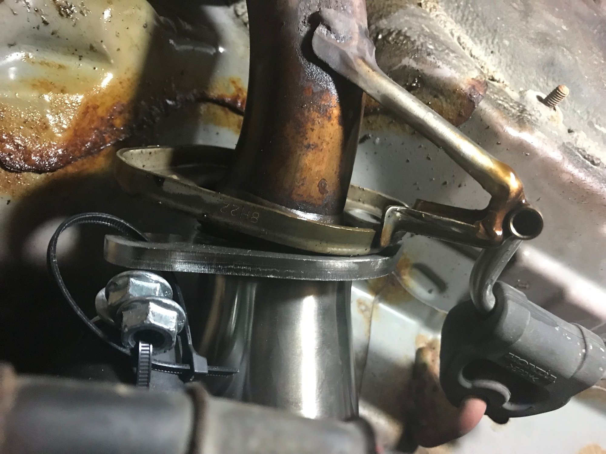

I was looking at the pictures again and just had a thought about the rubber hanger insulator you used... or specifically the way it's modified/mounted.
There is almost no de-coupling between the bisi and the car - only a few milimeters of hard rubber is what's separating them.
I can think of this as almost a solid connection once the exhaust moves so the two steel hanger press toward eachother.
This would likely transmit some serious vibrations/resonance through the trunk floor making it louder inside than it should be.
I can think of this as almost a solid connection once the exhaust moves and the two steel hanger press toward eachother.
This will definitely transmit some serious vibrations/resonance through the trunk floor making it louder inside than it should be
Great minds... I was thinking the same thing, so on Sunday morning I picked up and installed a different hanger from the local Autozone. I believe it did help a little, but not enough.

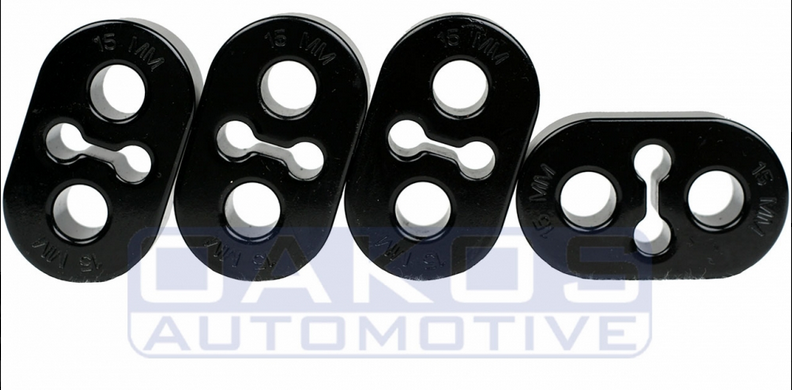

from my subaru days, a popular mod to "tighten things up" came in the form of 95A hardness polyurethane hangers
https://www.oakos.com/KB-011.htm
the side effect of making the car more firm/tight did come at the cost of added nvh. Rick, would you say that above nickson hanger ... is harder than stock? I'm wondering if something more "mushy" or rubbery .... may do it for you, and further insulate and reduce nvh ... like this?
https://www.autozone.com/emission-co...06_754773_5060
(or even better, if you could source some bigger/longer super wimpy oem ones off another car)
The Nickson hanger was relatively mushy, and significantly more mushy than the one I had originally installed. It seems like a good fit and I will likely leave it installed. If the weather holds, I may start my noise deadening offensive this afternoon...
