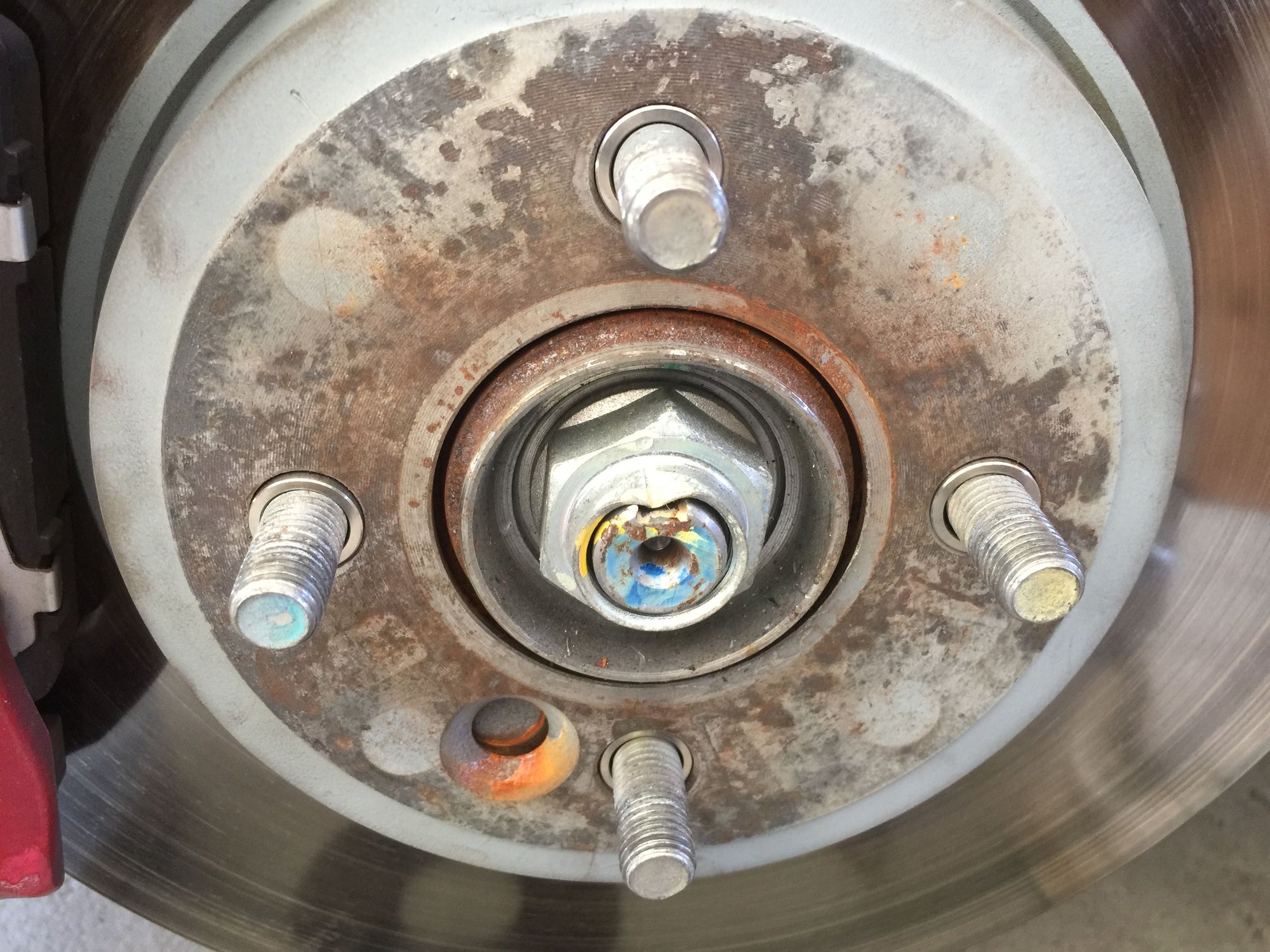

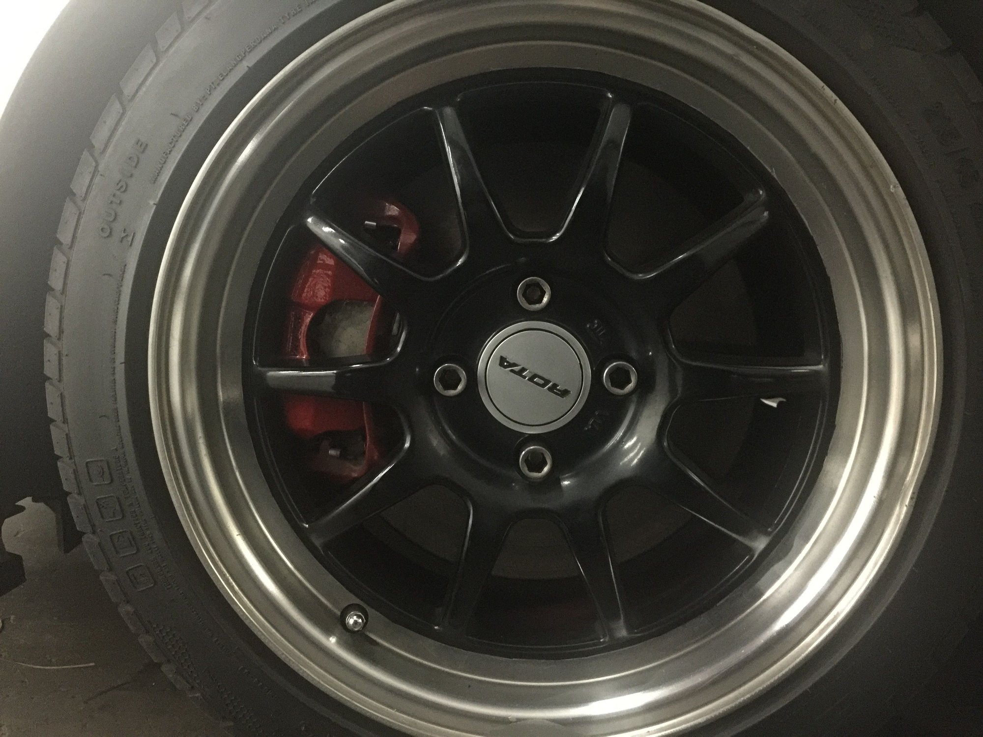

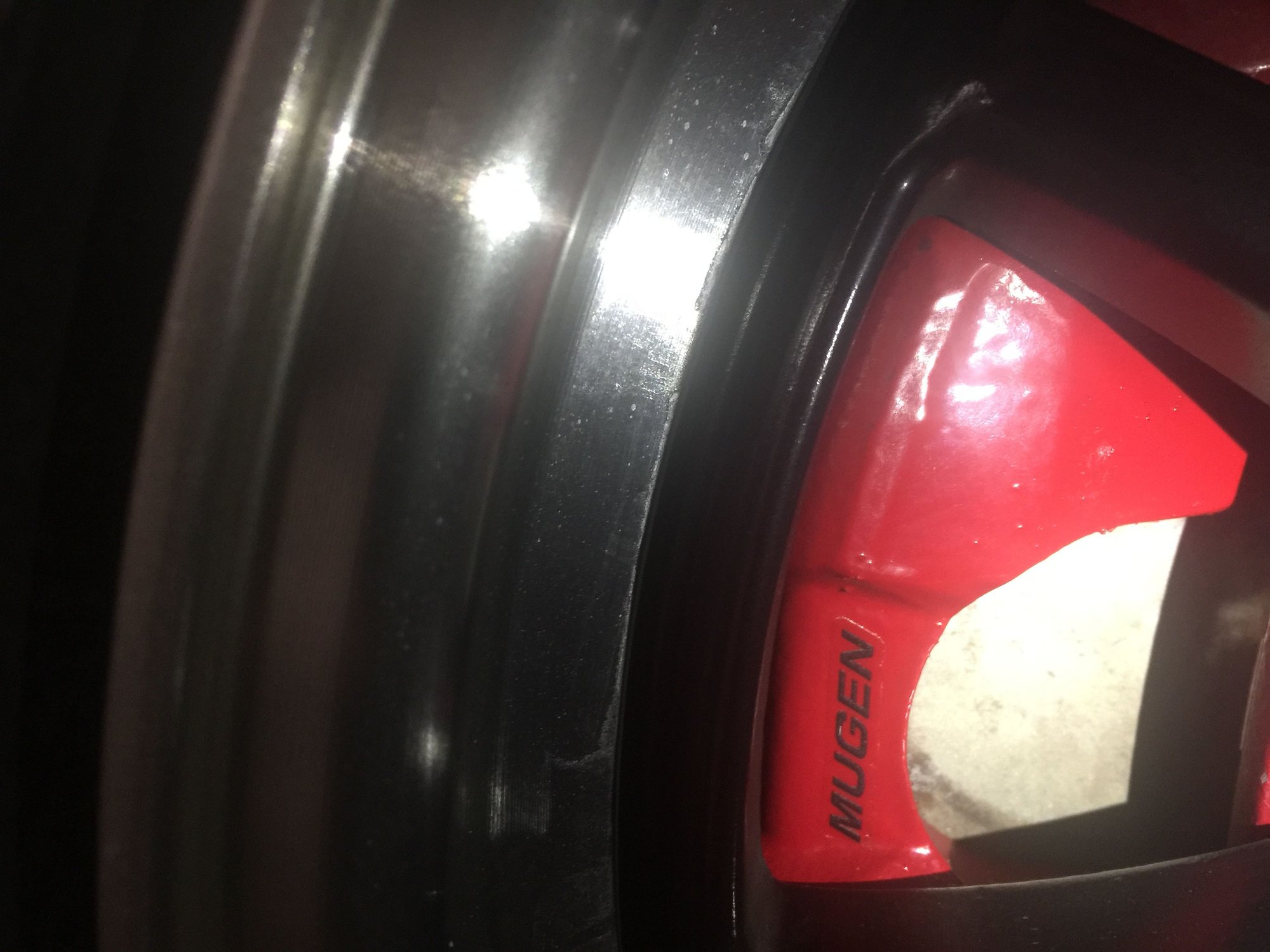

This is a 297mm Mini Cooper rotor with 2014 accord caliper and braket to run the mini rotor you need to get the stud spacer to center the rotor
This wheels are 16 by 7 offset +40 215 45 16 no rub 215 50 16 fender roll needed

This are the spacers
They great in

If I remember right type r wheels where 16” to clear the oem caliper
