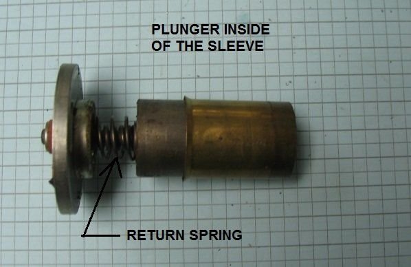

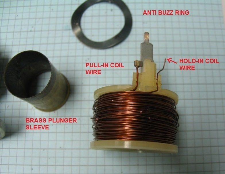

All starters that are using lubricated thin wall brass sliding bushing around the solenoid plunger and black bell shape rubber boot around the plunger end
Old solenoid (center) with bell shaped black rubber boot
Aftermarket
The edges of the sleeve are worn and serrated
The reman. starters from the stores are using solenoids with nylon sleeve and very thin red rubber boot . Some cheap rebuilds show heavy lube on the brass bushing and remover rubber boot
