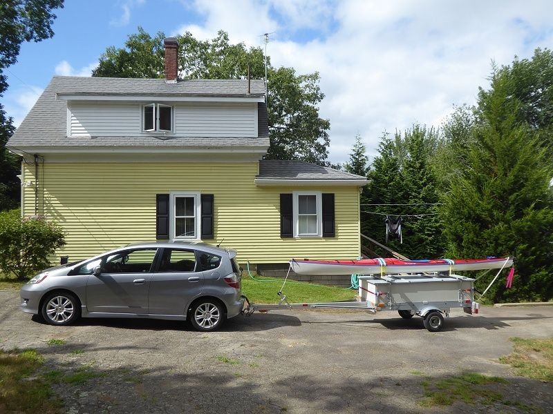

And, you might be concerned that a trailer won't do well on the rough roads up north. But realistically, with the Fit's low ground clearance, anything the Fit can go over wouldn't be a problem for a trailer. Here's my trailer behind the Fit. It has tiny 8 inch wheels (and a very long tongue for kayaks) but even those 8 inch wheels handle rutted dirt roads OK at low speed. A trailer with larger wheels would handle rougher terrain better than the Fit itself.
