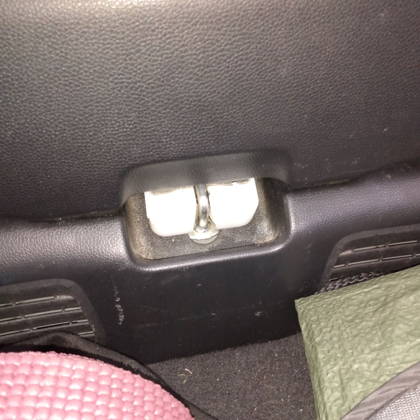

Any way to open this hatchback from the inside? It's a 2016 LX. I'm thinking of sticking a piece of shim stock alongside the bar in the middle. Maybe that will pop the latch. If that doesn't work I'm going to pry off the plastic molding.
