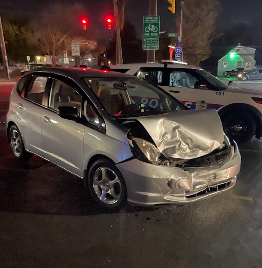

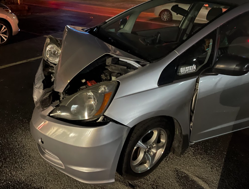

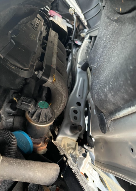

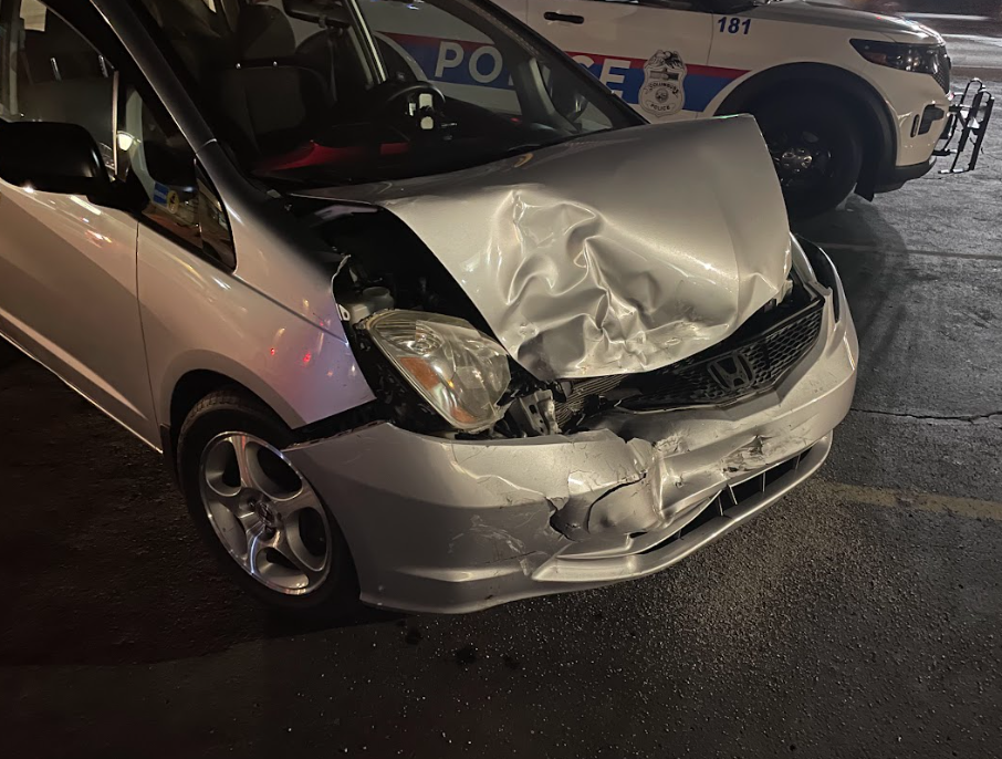

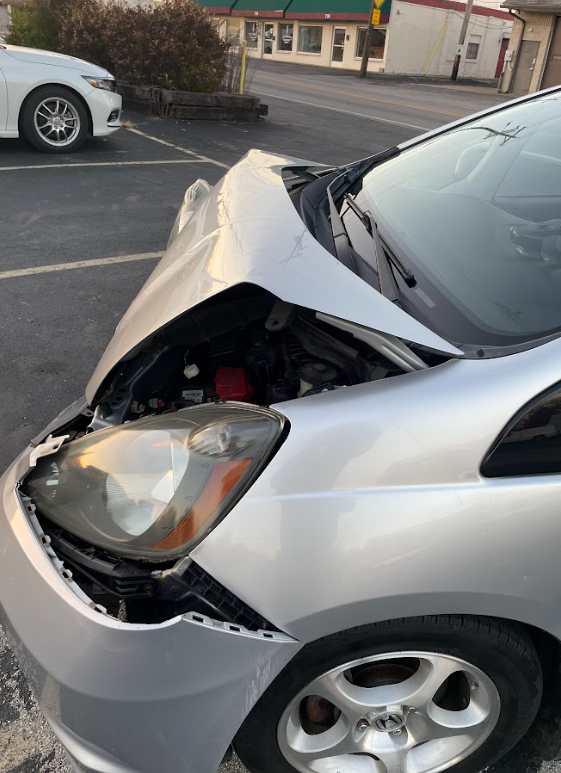

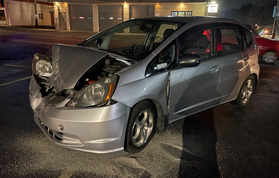

Hopefully these photos are helpful. Mainly worried about the frame. Body work and other repairs should be cheap enough although I think the oil filter got punctured and probably the alternator and ac compressor got some good contact too. I wouldn't bother replacing the fenders as the rest of the car is plenty dinged up.

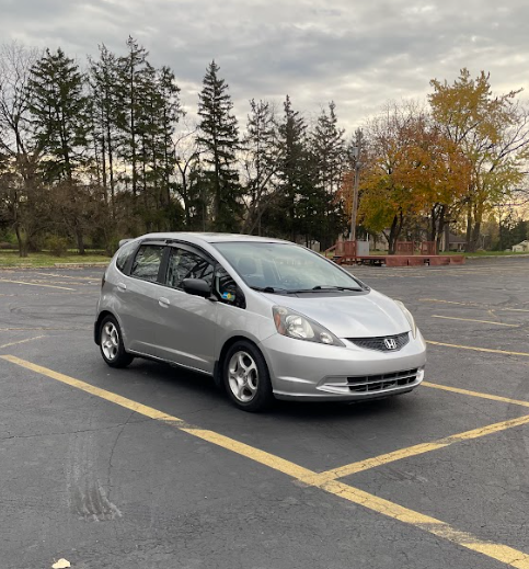

Photo of it before the crash too
Looks like the driver side fender needs replaced. Obviously the hood and front bumper replaced. Probably need to replace the front crash bar. You can probably salvage the driver side door and passenger side fender if you wanted.
As far as internal damage I can't really tell but I would definitely check the radiator, A/C, engine mounts and suspension components. You may need a new subframe but I can't confirm that. There could be lots of things I cant see. Those crumple zones put in some good work.
As for the frame rails they don't appear to be damaged from the outside but you need to get under the car and under the hood to confirm or deny frame rail damage. At first glace this seems fixable just depending what was damaged under the hood, frame rails and suspension components.
It could get expensive fast.

If you do get the insurance to help you out, it wouldn't surprise me if they consider your Fit a total loss. I've seen newer cars with less damage be written off.
That's not to say that you can't take a payout and repair the car yourself, but you might find that the amount they're willing to hand over might not be enough for the necessary repairs. It will all depend on the condition of the frame and how nice you want it to be. You've indicated that you don't need perfection, so assuming no frame damage you might be able to find a junkyard Fit and get front fenders, hood, bumper, core support, radiator, cosmetic trim pieces, etc. for relatively cheap.
